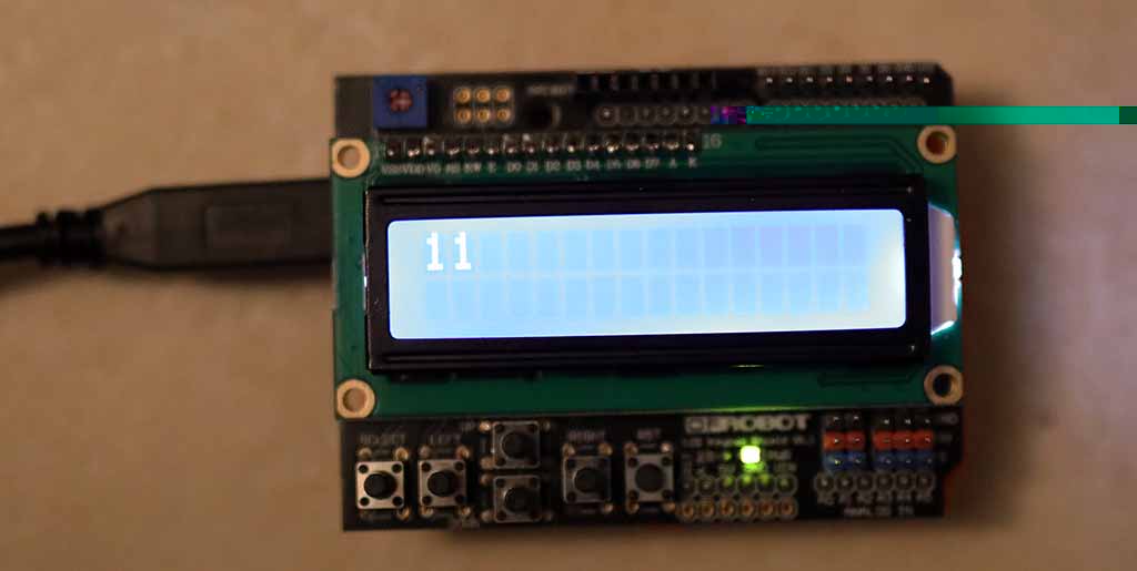

Hi !
If i do a simple program, reading a bit (Bool) and inverting it and printing, it works in simulation.
If i upload it in the target, the NOT does not works.
I also do the test with a byte and it's good.
Strange too, il i say TEST=0 and then TEST=NOT TEST, it works on target.
An idea ?
Yannick

Hi Yannick,
We're discussed this issue here and this is the situation...
Flowcode's operators "NOT", "AND" and "OR" are treated as *bitwise* operators in the code. If you know a bit of C code, these are the ~, &, and | equivalents.
If you want to have the equivalent *logical* operators, then you need to use the appropriate symbol !, && and || (these are the logical operators in C).
There's a further complication in that Flowcode's "bool" type is actually defined as a "byte" value in the generated C code. This is due to an issue with the compiler we are using. However, Flowcode's internal simulation treats a "bool" as a single bit. This is where the discrepancy is.
So in the code that runs on the microcontroller, if the bool variable TEST = 1 then NOT TEST = 254 (because it is actually treated as a byte value and in binary, NOT 00000001 is 11111110).
My suggestion is for you to use the symbol "!" in your code instead of "NOT" and it should work as expected in both simulation and on the microcontroller.

Hi Steve,
Thank you for your response. So for the moment we can't use NOT AND OR with a Bool.
Of course, i have change my code and use a byte and it works.
It will be good to correct this bug in the compiler in next versions... Who makes the compiler ?
Usually in tests (IF), i use boolean conditions with OR, AND.... and it works... so it does not seems to be same for boolean conditions that simple vars.
Thank you for your help.

Hi Yannick,
The compiler is from Microchip, but it is not a bug as such. There is a limitation in the way a bool variable can be used and Flowcode needs to work around this. The simplest way was to define a bool as a byte.
We will look at what we can do to solve this issue better, but it is not simple and any fundamental change may have unexpected consequences on users' existing code.
For now, the safest thing is to use the logical operators (!, &&, ||) when you are trying to determine a logical outcome (i.e. if a condition or result is true or false).
