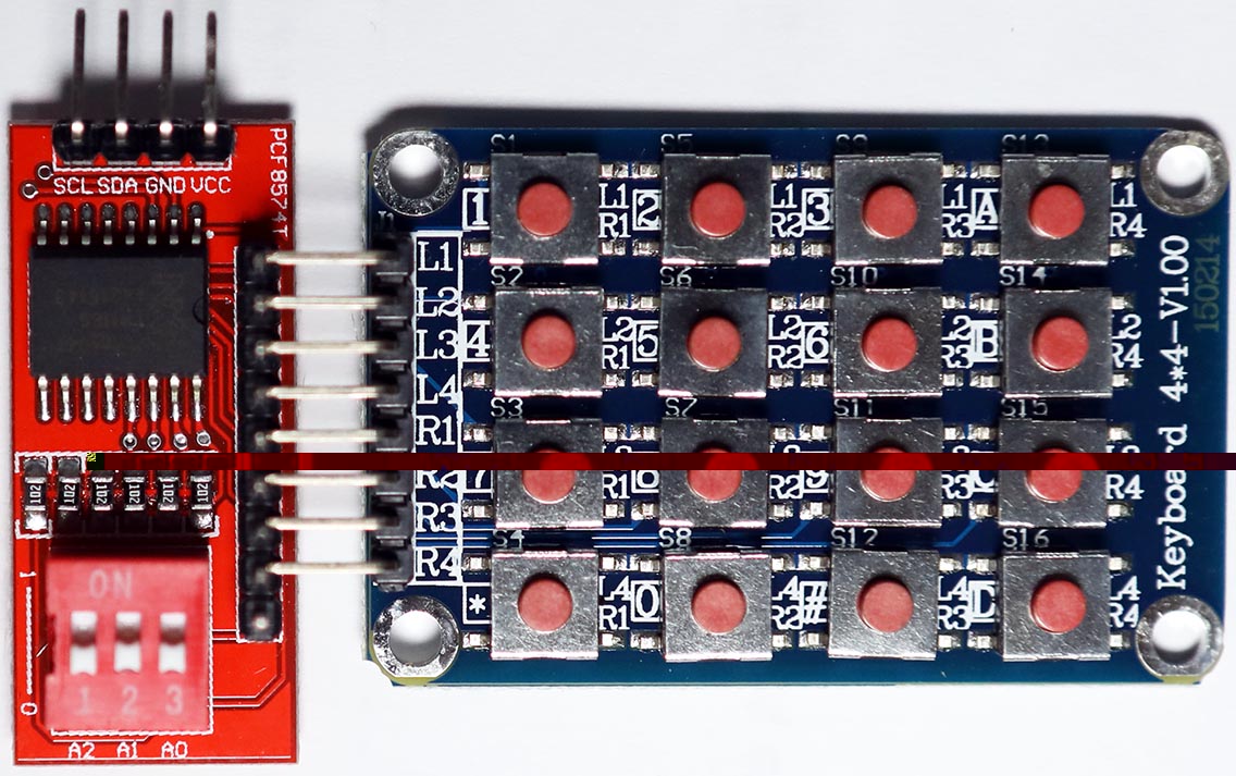

In the current version, there is no i2c keypad...
Is it in the roadmap ?

I have also been doing my own thing with I2C ( PCF8574, PCF8574A) Keypads, combined with an I2C LCD it is a great 2wire+power debugging tool I add to most projects.
If a Matrix Component was built to for I2C reading of generic keypads, it would be handy to be able to select the I/O assigned to the Rows and Cols.. since it can vary depending on what hardware your using.

Yes Jay Dee, it will be very usefull to have basic things working on i2c, and on the same channel too.
If i use the i2c keyboard from FC7 and a i2c sensor, i'm not sure that it will work on the same channel.
The i2c keypad (with config of row + col + key) is very important because the normal keypad ask 8 wires !!!

Hello and Happy New Year,
The PCF8574 looks interesting and similar to the MCP23S17 which I've played with previously.
To do this properly we need a way of adding external I/O pins which the components can then control directly via abstraction.
This in theory then allows all components to work via I/O expanders, makes the MIAC system run smoother and also allows Arduino style pin mapping to be much easier.
We have a plan for this but it's a big addition and is currently pencilled in as a version 8 feature.
For info SPI should also work fine like this as long as the slave devices each have their own unique chip select pins.

Hi Yannick,
As I see it, It's probably not simply an extra component its a substantial engine upgrade.
You would add the PCF8574 or MCP23S17 component and that would essentially provide extra I/O pins to your target device which you could then select in the keypad component, the LCD component or any other component using simple digital I/O, the fact that your using an I/O expander would become transparent to your Flowcode program.
Pencilled in for v8 as we still have a lot planned or in progress for v7. v8 is likely at least a year down the road.

Hi Yannick,
Not currently but it should be possible to control the PCF8574 using the Master I2C component.
Using the PCF8574 as a keypad should be as easy as setting one of the column pins high and then reading the row pins. If any of the row pins are high then you know that the switch is pressed at the current column and row address. Repeat for all columns or until you find a pressed switch.

Hi Benj,
In the fc7 file "i2c_keypad.fcfx" (top of discussion), i use the i2c component, and it works with the pcf8574 ...
but i havent any keypad to simulate in fc7.
