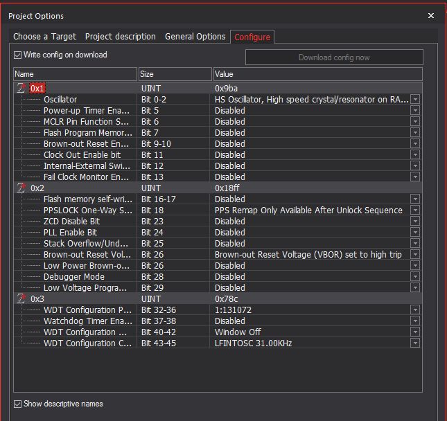

Re: GSM component on PIC16F1619 ERROR
Please check PIC16F1619 Watchdog settings.
Watchdog timer is always ON with fixed WDT period.
Program starts, works 3 seconds and restarts.
Program works fine only if set "auto clear watchdog"
UPDATED: Program do not work fine, WDT autoclear setting increase program restarting time from 3sec to 6 sec.
WDT enable-disable option and WDT period setting do not make any change : WDT always on with foxed period ~3sec
In attached picture WDT disabled, but really it is enabled Bug, or any my mistake?
Thanks!
It looks like it should be disabled, I've double checked with the datasheet and that seems to confirm.
If you increase the WDT Configuration Period does this give you a longer runtime? This would confirm that the watchdog is still active.
You can also try forcing a software disable using the following in a C icon at the start of your program.
WDTCON0 = 0x24;Regards Ben Rowland - MatrixTSL
