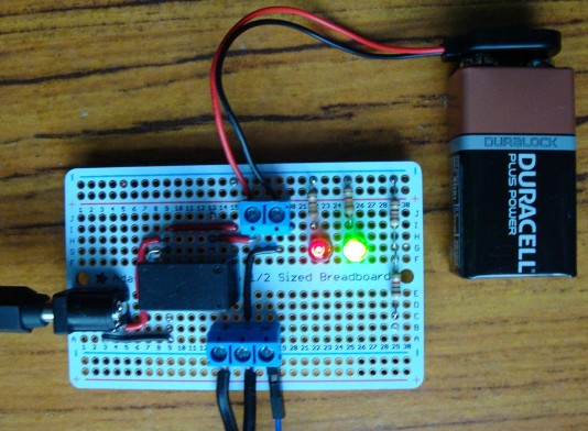

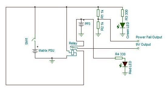

3.2 Description
The change over board consists of a single pole change over relay.
The NC contact is connected to the +ve terminal on the PP3 battery, and the NO contact is connected to the +ve from the Matrix PSU.
The power supply is also connected to one side of the relay coil.
The common output of the relay feeds the EB006.
All the commons are tied together.
When the power supply is working, the relay is energised and the 9V is fed to the EB006, switching off the battery.
If the power supply fails, the relay is de-energised, switching in the battery.
A pair of 1k0 resistors are connected in series between the PSU 9V line and ground.
This acts as a simple voltage divider. The centre tap (approximately 4.5V)is connected to the microcontroller. (Port E0)
This can be used to detect if the power fails.
By having the Matrix PSU plugged into the same socket as the unit being monitored, it can give warning that the power has failed.
Two LEDS are also present on the board.
Green : Lit when the PSU supply is present.
RED: Lit when a battery is connected to the board.
This system allows for the remote monitoring of the mains supply, without making a direct connection , which is unadvisable for the average user.
A suitably qualified user could build the change-over board inside an insulated enclosure with a suitable mains transformer, rather than using a Matrix PSU.

Power Change-Over Board Circuit Diagram.
ChangeOver Board.jpg (68.65 KiB) Viewed 6422 times

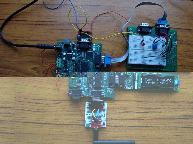

5.0 RF Board (nRF24L01) Connections.
The nRF24L01 is connected as below on both transmitter and receiver boards
Hardware Setting Channel 1
Port C2 CE
Port C3 SCK
Port C4 MIOS
Port C5 MOSI
Port C7 CSN

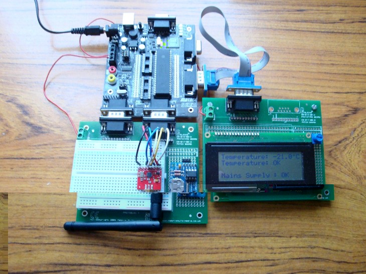

6.0 Remote Monitor.
This again has an nRF 24L01 RF Transceiver connected to Port C to receive the data from the remote sensor board.
The received data is displayed on a 4 x 20 LCD display.
Along with the remote temperature , the mains status and an over temperature alarm are displayed.
There is no feedback required to the remote sensor.
The temperature data is received as a 8-bit byte.
Because the temperature sent is in the order of -10°C (263 Kelvin) this is above the value that can be held in 8 bits, so prior to transmission, it has 100 subtracted from it.
Convert Received Temp To Float
Temp_Rx_F = int2float (Temp_Rx)
Add 100 (Removed prior to transmit from remote sensor)
Temp_Kelvin_F = fadd (Temp_Rx_F,100)
Convert back to Celsius
Temp_Celsius_F = fsub (Temp_Kelvin_F,273)
This is then converted to a string to display on the LCD.
Temp_Celsius_S = FloatToString$ (Temp_Celsius_F)
The display doesn’t show decimals as these are lost when converting to the integer to send remote sensor.
The Kelvin value is used in a decision to test if the value is above the alarm point.
Alarm = float2int (Temp_Kelvin_F)
Using a value of 263K (-10°C) a simple decision can be made
After receiving the temperature, the mains / battery status is sent as a 1 or 0 (1 = Mains Ok, 0 = Mains Failed).
Again a simple decision is used to indicated this.
Display Board.jpg (122.44 KiB) Viewed 6420 times
Display Board
