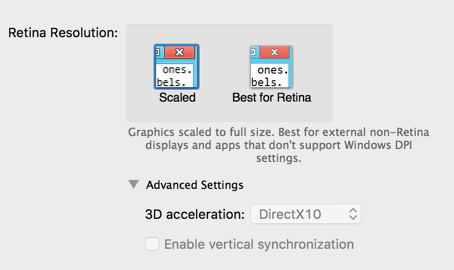

That didn't fix it (I'm already using DirectX10 acceleration) but does provide significant clues to the issue.Benj wrote:Hello,
Please can you try the link below and see if this helps to solve the problem.
http://kb.parallels.com/en/122856
Which version of Parallels Desktop are you using?

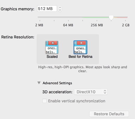

The MacBook Pro has a high DPI Retina screen. Parallels recommends the use of the high DPI screen in Windows via settings. This is what I use with all Windows apps.
Note that the settings menu says "Most apps look sharp and clear." With this setting Flowcode 7 exhibits the faulty behavior, while Flowcode 6 works fine.
If I change the setting to "Scaled", Flowcode 7 works as it should. But the graphics and text are fuzzy, not sharp, for Flowcode 7 and other apps.
Note that the settings menu says "Best for [...] apps that don't support Windows DPI settings."
Is it possible that Flowcode 6 supports Windows DPI settings but Flowcode 7 does not?

I'm using: Parallels Desktop for Mac Business Edition, version 11.2.0, running Windows 10.
