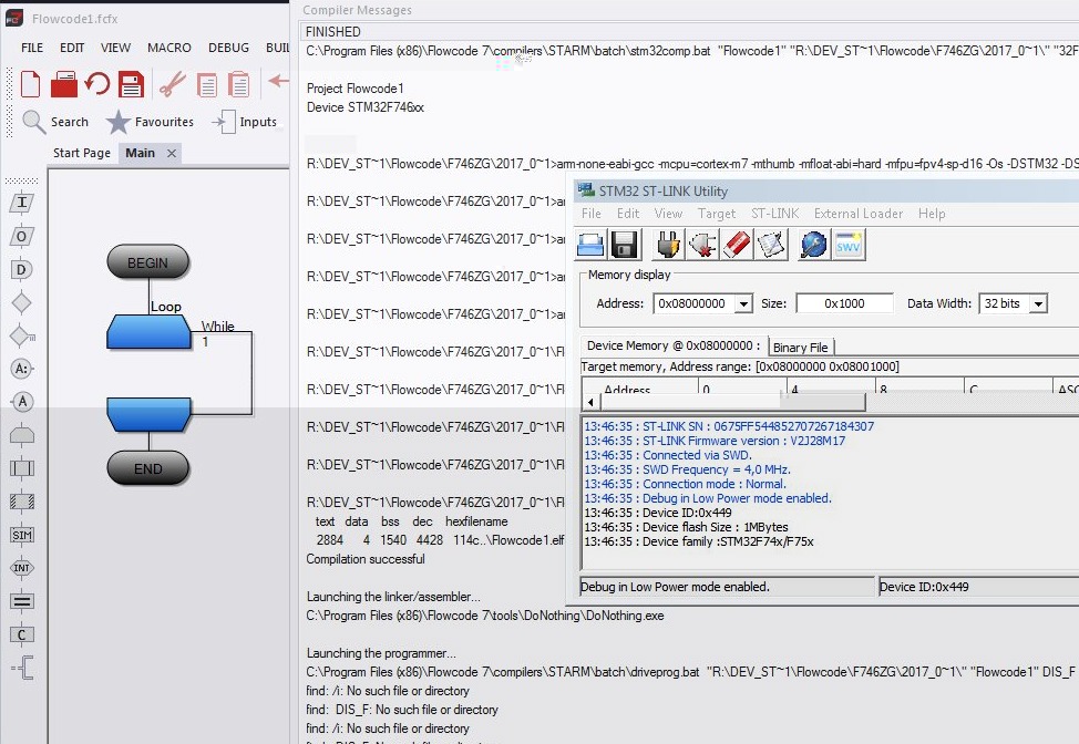

Re: Flowcode ARM for NUCLEO-F746ZG
That's good news
As a test I compile to Chip an empty loop
It is an issue that it doesn't find the programmer,
I also used the ST-link utility, just to see that NUCLEO-F746ZG is connected OK
This is probably a minor problem - what can I do ?
Best regards
BO
Best regards
BO
Try updating 32F746Nucleo144.fcdx in your FCD/ARM directory with this one attached
Leigh
Leigh
