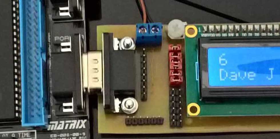

I am trying to venture into the realm of USB. I am using the following hardware:
- PIC18f4550
- EB006-30-9 Multi Programmer
- EB055-30-1 USB board (my design copied from Matrix)
- EB005-30-4 LCD Display (my design copied from Matrix)
The Flowcode program I am using is shown here:

The program appears to run ok on the hardware with LCD displaying correctly when connected to the computer (Windows 10 Pro Build 1607)

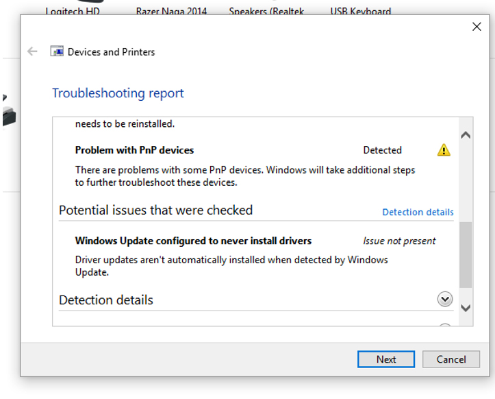

Thank You for quick replay. I have treid to update the driver to the one you have suggested, regretably, same problem.
Here is what Windows 10 displays:
Update Driver Software.jpg (221.57 KiB) Viewed 22554 times
I just don't know what the problem could be as to what is stopping it from starting! I am not that bothered about it being signed, I just would like to run.
Dave

Re: Serial USB - Unsigned Driver Fail
Unfortunatley Windows 10 is bothered about if it's been signed or not. It won't work if not signed. If the IDs are default then you can use our signed driver. In Windows 7 you simply got a red box saying would you like to proceed, much easier for developers to play around and one of the many reasons I won't be moving to Windows 10 any time soon.
Looks like it could be a configuration problem. What crystal are you using on the EB006 board? I'm assuming you've replaced the 19.6608MHz crystal with a 20MHz crystal. I'm told the 19.6608MHz crystal does work but it's probably right on the edge of working and would recommend using the right value of crystal if available.
The Build -> Project Options should have a clock speed of 48000000 as your multiplying the 20MHz up to USB speeds using the PLL. This will only effect things like delays and other timing critical parts e.g. UART baud rates.
In the Configuration tab set the CPU SYS CLK Select to OSC/1, this is hopefully what's currently stopping it from working as you currently have it set to OSC/4.
The other config settings look ok.

I have dug a little deeper and found this:
USB PnP Devices.jpg (201.22 KiB) Viewed 22550 times
So, not sure how to fix this one, I think its a 'Windows Device Policies' issue. I'll work on it over the next couple of days to see what I can find regarding 'PnP' USB communication. I'll keep you posted.
Dave

I can now confirm what I had suspected, the problem is due to system policies for Windows 10 Pro 1607.
As of July 26 2016 changes were implemented, as I understand so far. Here is a quote:
Starting with new installations of Windows 10, version 1607, the previously defined driver signing rules will be enforced by the Operating System, and Windows 10, version 1607 will not load any new kernel mode drivers which are not signed by the Dev Portal
The full article can be found here:
https://blogs.msdn.microsoft.com/window ... sion-1607/
Yes, I do have it working, but not without quite a lengthy workaround. I am working on a more permanent solution.
