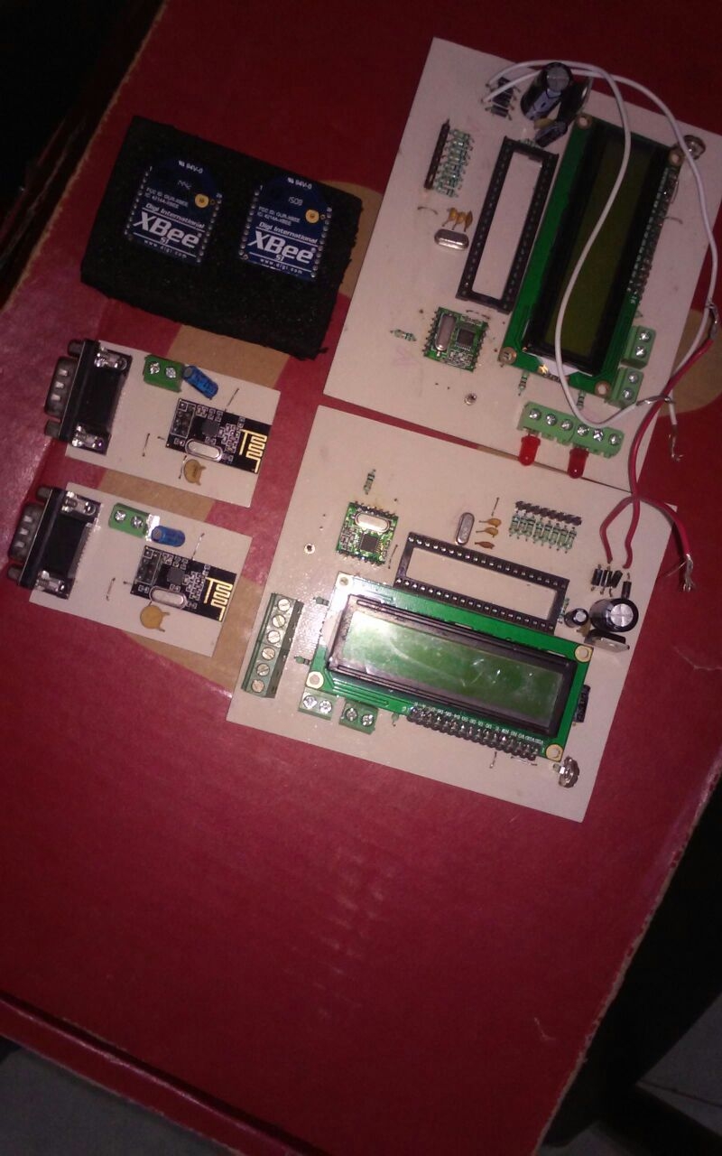

electron67
Posts: 323
Joined: Sat Jan 12, 2008 2:08 am
Has thanked: 106 times
Been thanked: 48 times
Re: NRF24L01!
Post by electron67 »
Hi Kersing
I also took time experimenting with RF components and the only one that has worked for me is the zigbee but is more expensive than the NRF I can buy 1 dlls each, the problem for me is the transmission distance, this component has good price but have failed communication in the examples (I have flow6), I probe also eb063 433 transiver job well but the example 12 inches distance, I think I have something wrong, but the job very well zigbee 100 meters, but costs 40 dlls; if the NRF would work as ZigBee to be great but more economical; with some components provides support us an example that works to understand how to program (sorry for my english)
