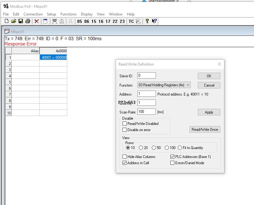

Dear sir i post the simple program that no reponse of the slave MODBUS component.
with modbus poll (i testing and validate the serial with the master modbus component its working correctly and µc it s ok )
Thank you for your colaboration to resolve this problem.
Best regards
C.Largy
Modbus Slave
Modbus Slave
- testing with adress slave at 0 with 1 i have time out error
- pbmodbusslave.jpg (72.81 KiB) Viewed 4586 times
- Flowcode1.fcfx
- (11.25 KiB) Downloaded 290 times

I have allready tested in my first program and the probem is present with checkforincomming macro, i think the problem is at the adress number check.
My program is very simple for my test i want just read a holding at 40001 on my cpu.
Thank your for your help.

You are not calling the component macro "checkforincomming" on the Modbus component
there is an example here
http://www.flowcode.co.uk/wikiv7/images/ ... mple1.fcfx
Modbus wiki here
http://www.flowcode.co.uk/wikiv7/index.p ... orIncoming
Steve
