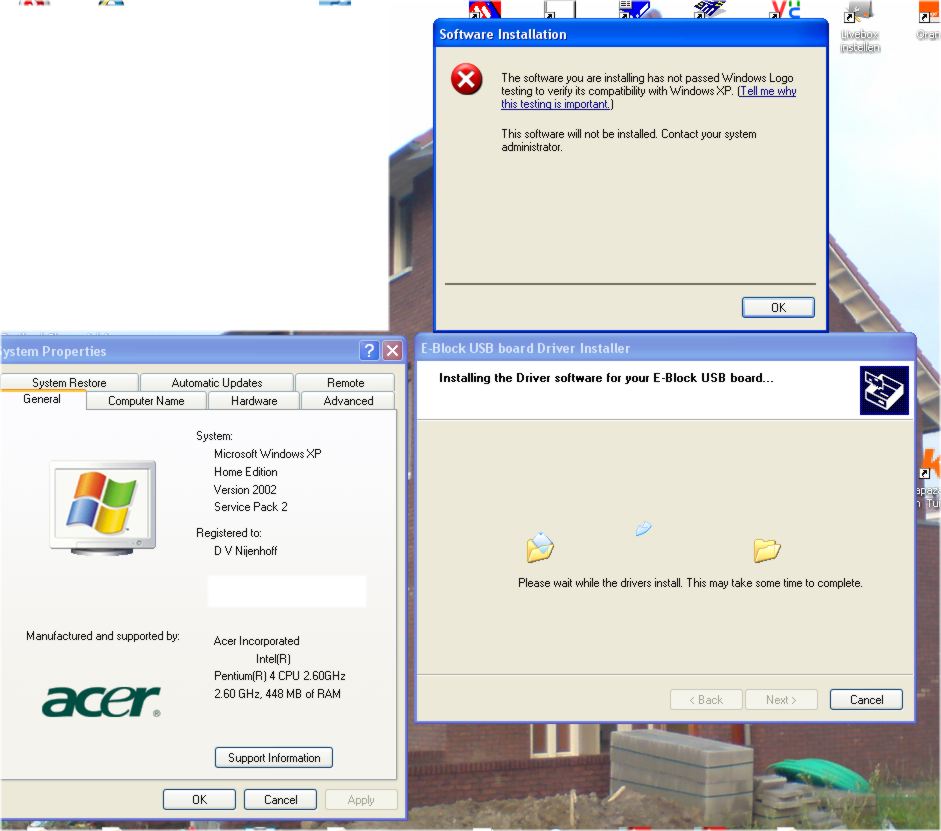

I can not install the usb driver at home ( at my work it was no problem ) for EB/006/00/6, i have tryed (10 times) serveral usb downloadΒ΄s, from site and mini cd.
I always get this software will not install. see JPG.
and i am logged in in windows as a system administrator
If you have same ideeΒ΄s, thank you

Hello
It looks like you have some security setting that is not allowing the driver to finish installing correctly.
To disable this security setting right click on My computer and then goto properties.
Then click on the Hardware tab and Driver Signing.
Switch the action to warn or ignore and then tick the box so that this becomes the default action.
Hopefully this should get you up and running.

Thanks, for the fast answer, i can install the driver now, and it is working
