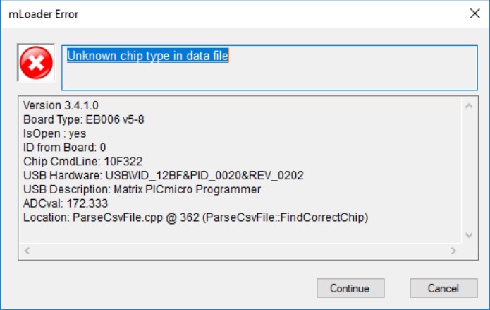

I have used a PIC10F322 in a project and want to program it with the EB006 programmer.
When uploading, an error shows, "Unknown chip in data file"
Does anybody know what the problem van be?

Hi Rinie,
I'm afraid that the EB006 does not support programming 10F devices. You will likely need a PICkit 3 or similar to be able to reprogram them.
