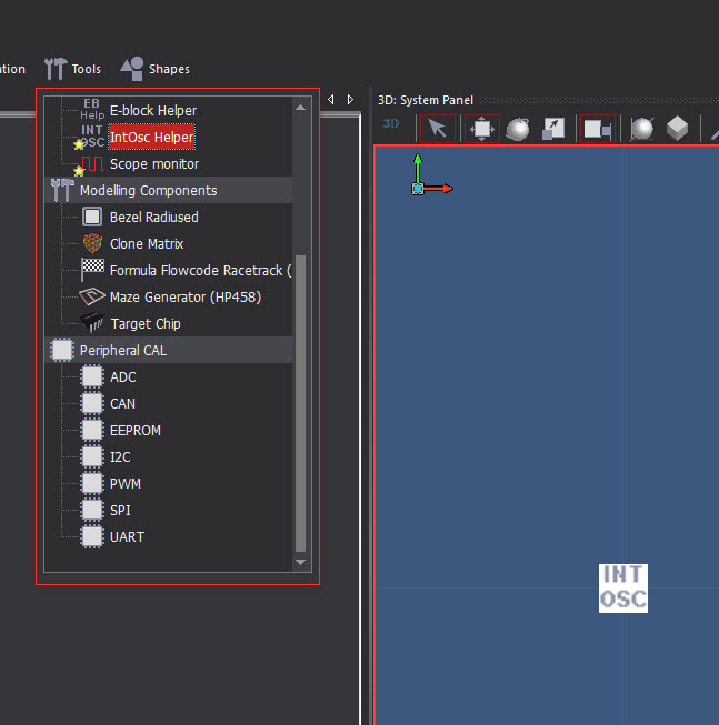

Are you setting the OSCON Register with the flowcode Oscillator Helper or you have to do it with a C code component
if you can post a minimum project then we could help you
- 1.jpg (66.36 KiB) Viewed 5340 times
