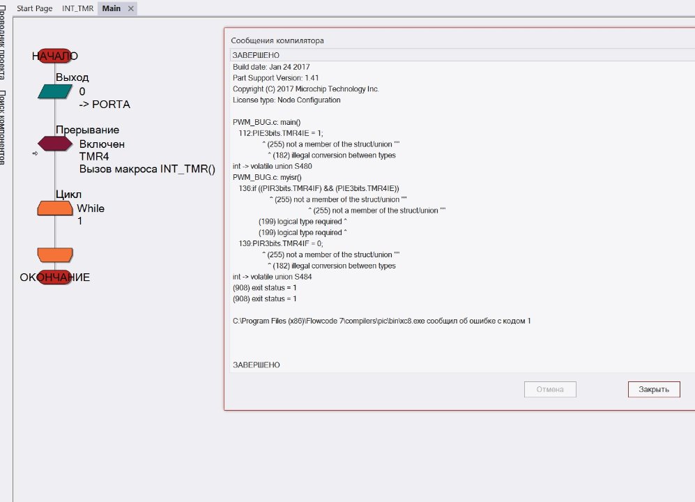

PIC18F67K22 interrupt TMR4 problem bug
Post by Osta »
PWM_BUG.fcfx
(8.24 KiB) Downloaded 470 times

Re: PIC18F67K22 interrupt TMR4 problem bug
Thanks for letting us know of the problem.
Please copy the attached file into your "Flowcode 7/FCD/PIC" folder, restart Flowcode and the problem should now be resolved.
18F67K22.fcdx
(53.59 KiB) Downloaded 525 times
Let us know how you get on.
Post by Osta »
Thank you Benj!
Everything is working!!!!! :D
