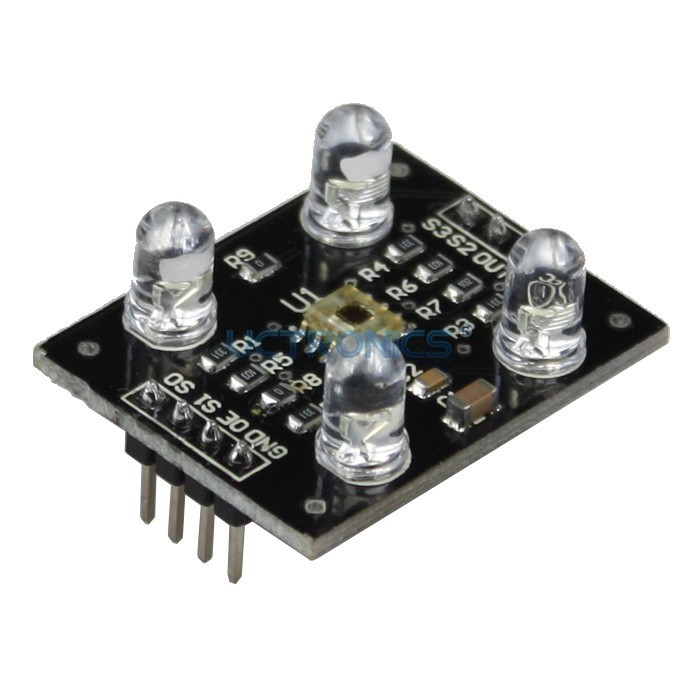

Hi, can I replace the EBM018 for TC3200? And I want to use the PIC 16F88 or 877A. :?
Re: Color Sensor TCS3200
The EBM018 is basically just the TCS3200 on a PCB with an LED, much like the boartd you showed in your picture.
The 88 or 877A should be fine.
Let us know how you get on.
LeighM
Posts: 2178
Has thanked: 481 times
Been thanked: 699 times
Post by LeighM »
The EBM018 component won't work directly with the TCS3200,
as our EBM018 also has a serial controlling interface device that is used to set the S0 to S3 configuration inputs.
So you will need to make your own port pin connections to S0 to S3 to set the colour filter and frequency range of the TCS3200.
Once you have done that, you can then probably use the GetFrequency macro of the EBM018 component to read the relative light intensity.
Note that all the other macros of the EBM018 component will not do anything, as they expect the EBM018 interface.
The following example page should help you...
http://www.flowcode.co.uk/wikiv7/index.p ... 424cbca6b0
Hope that helps,
Leigh
