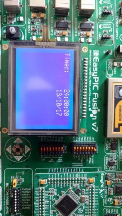

I was able to get the print of data displayed on the KS0108 but the values are not changing. I tried to include as you can see on the code an increment for variables hour, min and sec, but they are not changing at all.
As you mentioned on your last post, I enabled the secondary oscillator and I also enabled primary as XT with PLL, the result was a faster display of data on the screen. The only problem is the incrementing of value. I tried different configurations but this one was the best. If I only let enabled the secondary oscillator and external clock as primary enabled with no PLL, data are not displayed on the KS0108.
Am I on the right track? Next step, Ill try to include some buttons so I can set manualy a timer for each variable.
OBS: Another thing that I had to change on the code, was the component option for KS0108, in the simulation and download of the code I had to use to controller count option number 3 for 192x64, instead of the 128x64 which is the real hardware that I have. Can you explained me why this is happenning, because I believe I should be using in simulation the same as in hardware correct?
Rod

1) The RTC initialise is currently being called as port of your main loop. Move this from the Timer macro into the Inicio macro to avoid calling it repeatedly.
2) The same goes for setting the values for the date and time, Your Timer macro should only contain the Get component macros. All the Set component macros should be outside of your main loop.

Hi Benj I did the modifications you mentioned and it worked. Thank you! The only problem is that the refreshing of data displayed into the KS0108 for every second has to be clear, otherwise the numbers get overlaping to each other. I tried different places for the component macro clear display, but the numbers on the screen are jumpie! I Figure that the clear display has to inside the main loop because it will always be true that it needs to be clear the display for a new data to come up. I Uploaded the code so you can see.
Do you have any suggestions for the display?

When printing the time and date strings simply set the Transparent parameter to 0 instead of 1. This will ensure the text prints correctly and without overlapping. This should mean you no longer need to call the clear display macro in your loop.
