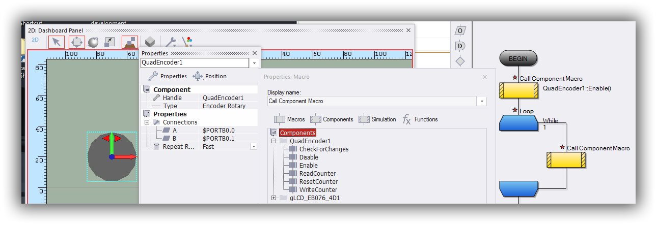

For evaluation I use PIC16F887 at the moment.
It has a 16 bit timer / counter
Is there a general approach in FC7 to pick an input pin for CountUp and an other Pin for Reset ?
That counter should work independent of everything else.
Is there a method to read the counter inside the program execution.
When searching for this I found that FC7 supports "Inputs Encoder Rotary " although PIC16F887
doesn't have any hardware Quadrature Encoder Interface.
If this works it is great and could be a substitute for the counter
The question is how it works. Does an independent counter work
or is it a software counter that will slow down the processor ?
Is it possible to take a look inside the macro and see what it does ?

The Quadrature Encoder is a software component, that maintains a readable counter.
You would need to call CheckForChanges regularly in a loop as this updates the counter on change detection.
So it depends on your pulse rate (and width) how often you would need to call this.
Alternatively you could use an input or timer interrupt and call CheckForChanges in the interrupt routine.

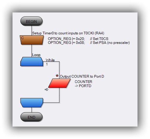

So this would be the C code to set up TMR0 to count pulses on T0CKI (RA4)When used as a counter, the Timer0 module will
increment on every rising or falling edge of the T0CKI
pin. The incrementing edge is determined by the T0SE
bit of the OPTION register. Counter mode is selected by
setting the T0CS bit of the OPTION register to ‘1’.
OPTION_REG |= 0x20; // Set T0CS
OPTION_REG |= 0x08; // Set PSA (no prescaler)
Re: Use the timer as counter for external pulses

Try the attached.
(Change the target device to your 16F887)
Regards,
Leigh
Try the attached.
Regards,
Leigh
Thanks indeed for PIC16F1937 COUNTER.fcfx
It would be great if that can work,
I tested with right circuit
a PIC16F1937
and simplified by removing the reset just to get a first indication.
On my testbench I already have a CMOS COUNTER 74HC4040 that delivers pulses to all Port A inputs
That should give TOCI (RA4) enough pulses to work on
I tested output on port B (as in source) and then changed to port D
Unfortunately I am not getting the expected functionality yet - just hoping that perhaps only a small detail is missing.
Would it also be possible to reset the counter directly on the hardware without using the program flow ?
If yes, it will be possible to use very high count rates and very short reset pulses

I am not sure what you are asking however if you are talking about the Flowchart you posted and you have no output on PORTDI tested output on port B (as in source) and then changed to port D
then dont you think you should read the timer and move the value to PORTD to be able to have an output on PORTD as the example code does
I would suggest you to make an effort to read the datasheets of the devices you are using as most of your questions are questions that are described in the device datasheetWould it also be possible to reset the counter directly on the hardware without using the program flow ?
any case any timer will automatically roll over meaning when it reached it's maximum bit count (8 bit timer will go to zero(0) when 255 is reached and a 16 bit timer will roll over at 65535 ) to answer your question if your application needs to reset the counter before Roll over then there is only one option a SW reset
it depends on what you mean with high count ratesit will be possible to use very high count rates and very short reset pulses
Now it works,
This is the true power of Flowcode that beginners and dummies can create great and awesome things,
I am deeply impressed.
Thanks for valuable points of view and all the friendly comments.
This paves the road for much higher count frequency than a software solution.
10 - 50 MHz expected, depending on chip. I guess a 1000 times higher count frequency than software based.
Only my short reset pulse is still a problem.
This can halfway replace my real goal "The Quadrature Encoder" It is in fact a QEI that only counts forwards.
In the beginning of this post I understood that
in PIC16F887 the Quadrature Encoder is a software component, that maintains a readable counter.
What's about dsPIC33EP512MU810. It has two hardware 32-bit Quadrature Encoder Interfaces (QEI)
Flowcode has two such QEI components for that very chip. Are they based on the hardware or are they the same software component as in QEI-less chips ?
That answer determines if Flowcode can make dsPIC33EP512MU810- QEI work with 50 kHz or 50 MHz,

Too my knowledge the QEI component in FC is a pure software implementation regardles PIC dsPIC ,PIC32, AVR or ARM micro'sWhat's about dsPIC33EP512MU810. It has two hardware 32-bit Quadrature Encoder Interfaces (QEI)
Regards QMESAR
Regards QMESAR
Just what I guessed. Good to have in confirmed.

Try the attached.
Regards,
Leigh

I tried your flow chart to count the external pulses on RA4 pin using PIC16F1938 and it works perfect, I tried to modify your program to use with PIC18F46K22, but unfortunately it dint work, kindly excuse me but i am not at all good with "C"
I will be happy if someone could shed some light on how to configure the PIC18F46K22 to work as a counter. I tried to read few post on this topic but did not find or may be i did not understand, as i said i am not good with "C".
Thanks in advance.
Abhi
