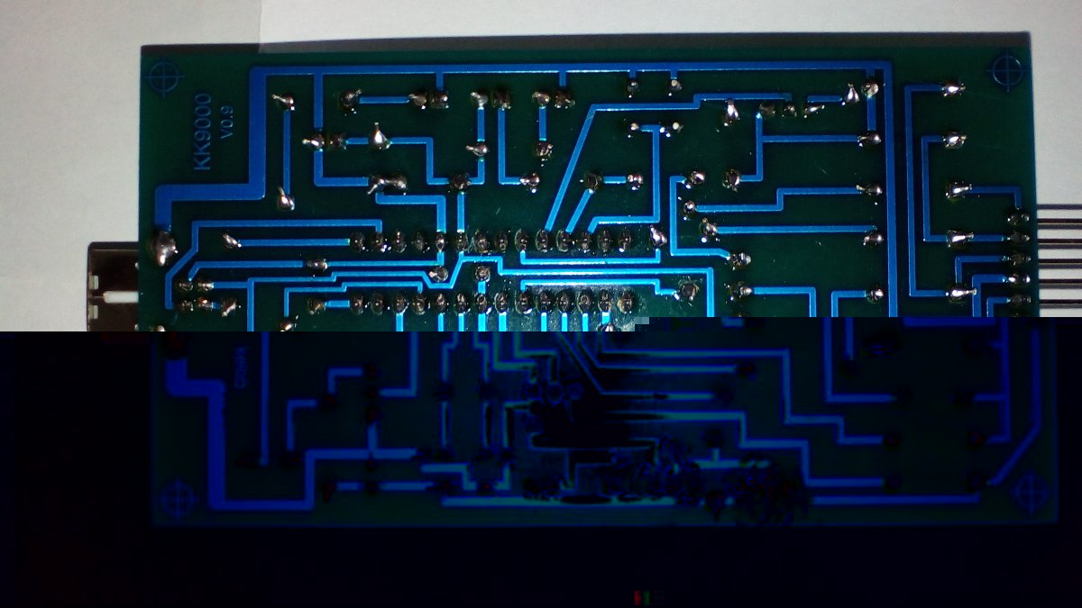

I have this clone, that I have bought years ago, when I tried (and failed) to learn programming. So, I actually never used it.
Now, that I bought FlowCode, I want to use it. So, I have connected it to the computer and opened Microchip PICKit program, and clicked on Troubleshoot. In there I can check voltages on PICKit output pins. All voltages are fine, except when MCLR pin (pin 1) is supposed to be low. For me, it is 3,75V. When it is high it is 4,4V (which is fine). But it does not go low.

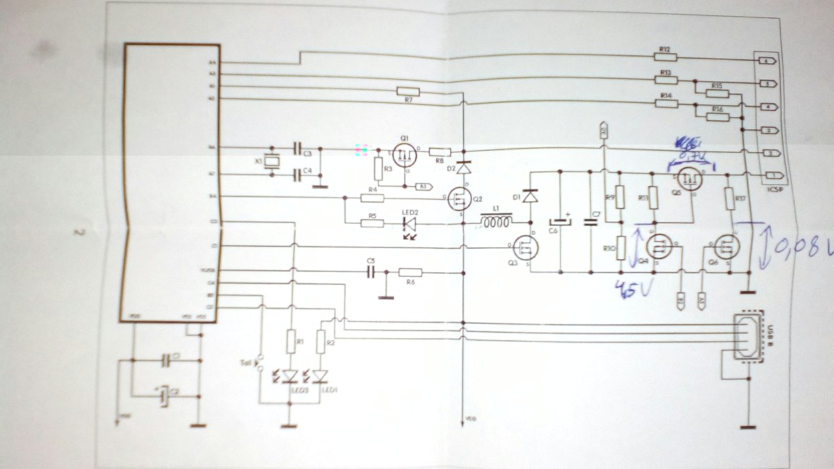

Here is the schematics.
I have changed Q5 (BS250), and Q4 (BS170), and it is still the same. Q6 is turned on, so the pin 1 is pulled to the ground, but there is a parasite diode in Q5 that causes problems? Q5 should be fully off. I get 3,75V when pin 1 should be low.

With nothing connected to the PICkit2 I get the following voltages on pin1 (MCLR) relative to pin 3 (GND).
Test VPP - 11.92V
MCLR On - 0V
MCLR Off - 0V
On your hardware that you're connecting how is the MCLR pin connected to VCC? We usually connect a 10K pull up resistor between MCLR and VCC to separate the two. If your pull up is too low a resistance then the FETs in the PICkit won't be able to pull low correctly and will also be pulling VCC low.

Re: PICKit 2 Clone - hardware problem
Vpp = 12V
MCLR on: 3,75V
MCLR off: 4,4V (this should show high voltage but you get 0V, hmm?)
This is mine, with nothing connected to the PICKit 2 pins.
