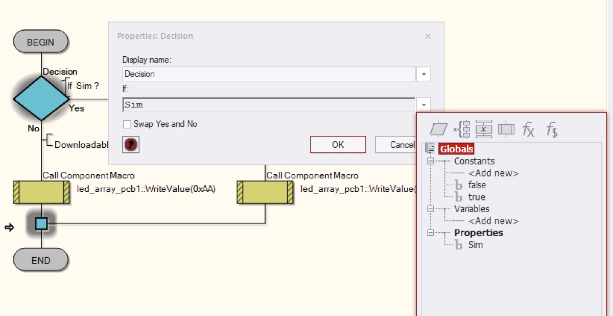

In your program, decision box has a "sim" property:
Screen Shot 2017-10-30 at 10.08.05 AM.JPG (109.98 KiB) Viewed 5885 times

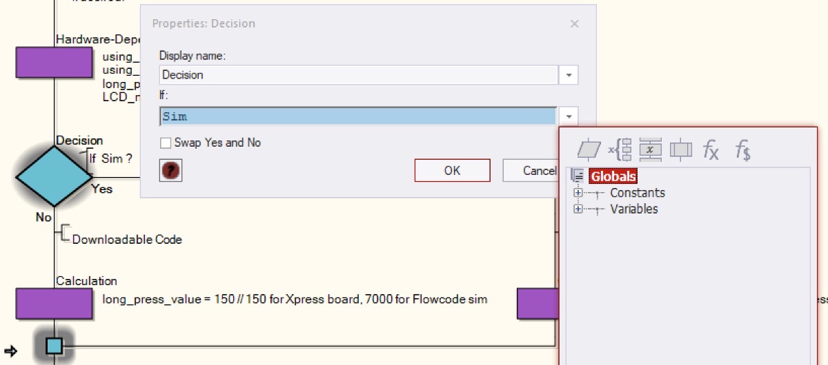

In imported macro, decision has no property:
Screen Shot 2017-10-30 at 10.06.33 AM.JPG (99.47 KiB) Viewed 5885 times

Here are some instructions to replicate what I did in the example.
On the properties window, ensure that Panel is selected on the drop down list at the top of the window, click the drop down next to properties and select Add new, Change cosmetic name to Sim, Property type to True or False, Property Variable to Sim. Click OK and ensure the property value is set to No. I also unticked Writable to stop the user from manually changing the value but this isn't required.
On the project explorer window click on the Events tab, scroll down to the Simulation -> Start, double click the Start item, double click <Add New> and click OK twice, repeat for the Simulation -> Stop item. This should create you two new macros named EV_Start and Ev_Stop which are automatically called when the sim starts and stops.
In the Ev_Start macro add a simulation macro icon. In the icon properties choose the Functions tab and then choose Component -> Property -> SetValue. Use the parameters this, "Sim", True. Do the same in the Ev_Stop macro, this time with the parameters this, "Sim", False. this refers to this component, "Sim" is the name of the property in quotes to avoid referring to the property value and the last parameter sets the state of the property.
You can now add the Sim decisions anywhere in your program where Sim and download need to do different things.

Very nice explanation, thank you, Benj.
I can now see why simply exporting and importing the macros didn't work, there are a few more steps involved.
