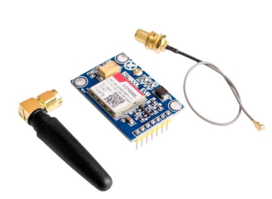

Francisco Cabrera
Posts: 47
Joined: Sat Mar 19, 2016 4:56 pm
Location: Canary Island
Has thanked: 23 times
Been thanked: 7 times
Re: GSM/GPRS
Post by Francisco Cabrera »
Thank you for answering,This it is of the first generation, Now there went out the version V2.05V for 5,5 GBP, I leave photo,
I think that also it has to work...but I'm not sure. regards
electron67
Posts: 323
Joined: Sat Jan 12, 2008 2:08 am
Has thanked: 106 times
Been thanked: 48 times
Re: GSM/GPRS
Post by electron67 »
Hello
then with version 1 it works well, I just bought this model (version 2) and another one that is model A6, I want to do test with voice and data
