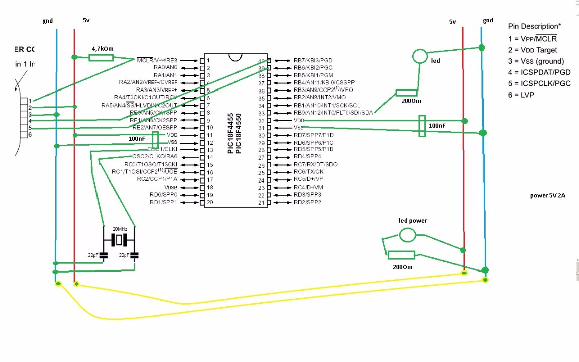

Hi.
I made a simple program for the microcontroller pic18f4550 and pickit3 + flowcode7,
but see the error when the firmware of the chip.
What could be wrong in my case.

kersing
- Posts: 2045
- Location: Netherlands
- Has thanked: 553 times
- Been thanked: 1081 times
Re: pic18f led blink error
Have you connected pin 31 and 32 to ground/power as well? If not the device might respond unpredictable.
Looks to me like programming has failed during the verify stage.
Programming...
The following memory area(s) will be programmed:
program memory: start address = 0x0, end address = 0xff
configuration memory
program memory
Address: e Expected Value: 44 Received Value: 40
Failed to program device
Programming Target Failed.
To program the 8-bit devices that are designed for 5V you need to be powering them at 5V. I've had similar problems programming the 16F and 18F devices at 3V3. The 16LF and 18LF devices on the other hand cannot be powered at 5V and should program fine at 3V3.Programmer to target power is enabled - VDD = 3,250000 volts.
I found a power supply at 5V,
and connected it,
also connect the contacts 31 and 32,
the chip is programmed, but there is a window
Hi.
I changed the compiler and the programmer.
then came the error L
next, I changed the FILE PK3CMD.exe in the folder
C:\Program Files\Flowcode 7\tools\PICkit3
Programmer pierces program
but the led never flashes.
As far as I know,
after flashing I have to press the button on the programmer pickit3,
further the microcontroller to start the program?
Or do I need to check with a multimeter the contacts and check if he gives voltage with a period of 1 second.
the led is reversed (polarity),
but the LEDs are not.
this is my circuit on a development Board,
voltage 33 contact outputs about 1.4 V
I'll try to install an older version flowcode
or to flash microcontroller using mplab
- breadboard.jpg (100.7 KiB) Viewed 10265 times
As I have previously stated, issue could be your configuration settings?
If your not willing to post flowchart then we are unable to determine if that is the case or not.
