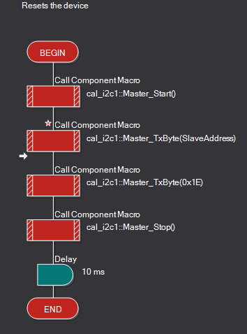

Here is one more thing related with Reset Macro.
The initial code written by Ben is next:
Initial code_Reset.jpg (29.09 KiB) Viewed 19878 times

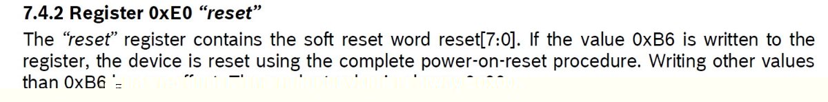

But the datasheet on page 25 says:
And the C code from CCS project has next line:
BME280WriteByte(0xE0, 0xB6);

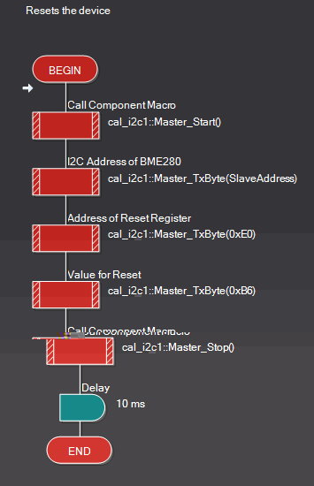

Then should not be the Reset Macro as follows?
Correct code_Reset.jpg (34.22 KiB) Viewed 19878 times
If I try with your component or my component BME280 and apply soft reset with the Reset Macro, then nothing happens with the readings of temperature or humidity.
If I apply the soft reset with the modified Reset Macro as above, then right away the readings are 0 for all, temperature, humidity and pressure and it requires a new initialization in order to read again values.
So I guess the initial Reset Macro code with 0x1E is not right and the corrected one below with 0xE0 register and 0xB6 value is right.

OK, thanks for that, it was on my list to check the reset due to your previous comment, looks like there is more to do.
Thanks, I'll fix the component
Edit: Fixed component attached - thanks!

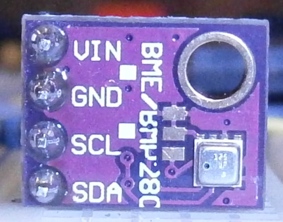

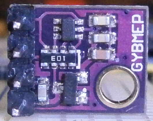

Here are few more observations.
The altitude calculation is a crap. I would take it out of the component macro.
I have the sensor on my table and it changes too much. I had values as 70m, then in another day 116m and today 250m – and all that without any change in the software/calculation or hardware. Of course today was 1st real snow and the atmospheric pressure changed over the night. The change of calculated altitude is too high for the same point. Either I do something wrong in calculation or we can just not relay on it due to the way how is calculated based on pressure.
Then I made some current consumption measurements according with the datasheet.
Unfortunately I cannot get the same values as in the datasheet, I guess because my BME280 sensor is mounted on a small break board where other more components are installed, probably including a voltage regulator, capacitors, resistors and the values from datasheet refer strictly to the senor.
In my case I measure the current at VDD of the break board.
The values of the current consumption are:
- In sleep mode around 6.5-7.5uA, then in forced mode when it wakes up for burst measurements the current goes up to 750uA.
- In normal mode, it depends by the standby time, but with 0.5ms I have 750uA for normal operation and 1.4-1.5mA during measurements. I did not measure exactly the duration of the measurements with the oscilloscope, but seems less than 0.5s – visually seen on the multimeter.
- From my point of view 7uA in sleep mode and 750uA during measurements is good enough for portable application, if we set the sample rate of the measurements let’s say 1min or more.
My I2C BME280 can be seen below:
