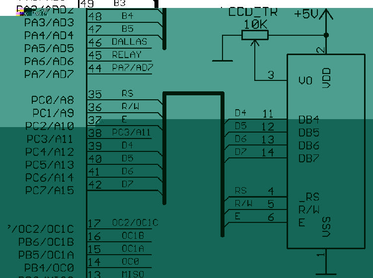

I have one question about an LCD what I use:
it is an L2012 2x16. I tried to connect it but I get only flimmering the first line.
I tried to connect in Flowcode as shown in the attached picture.
There is only Data1 to Data4 in the Flowcode and in the picture (and the board) I have Data4 to Data7. Data1 to Data4 is not used on the board.
How can I connect to get out the data on my LCD?

There is a definition in the new .fcd file that should prevent the compiler from looking for URSEL. If you have downloaded the fcd file to your Flowcode fcd folder you will need to close and re-open your program before the change is recognised.
You can set up the LCD connections in the Flowcode LCD component properties page as follows:
The Flowcode LCD component does not use the R/W line so an output command will be required to force PORTC1 low at the start of your program.

Hi Sean,
Thanks for the help.
I missed the R/W line... so I have to implement that. Thank you.
I connected the PortC1 to ground and it started, but the text it seems to flashing...
Tommorrow I will set an output command to force PORTC1 low at the start of the program.
