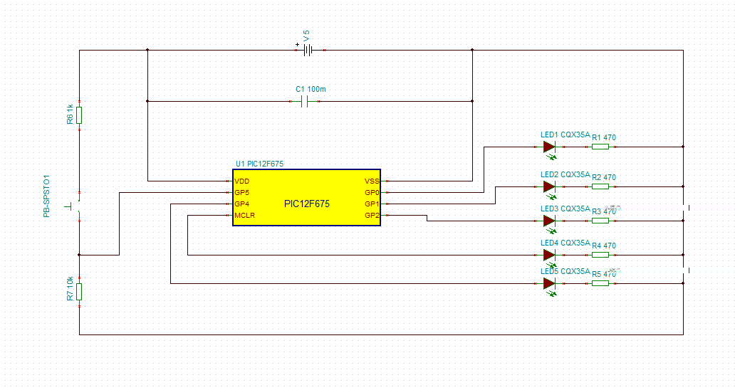

I have made some changes to the original code, to add back in one of the loops that I originally had but took out for trouble shooting, and the updated version is attached along with the circuit.
Without the switch, this circuit worked great and was proving to be reliable, it was once the switch was added that all went the way of the pear!
I also took the cap out just in case it was causing an issue but it made no difference.
Where would the parameter be for enabling weak pull-ups?
Apologies for my naivety, it has been such a long time since I played with electronics, and still finding my way around Flowcode although I'm enjoying the challenge and do like the software :D

Posts: 9521
Has thanked: 2585 times
Been thanked: 3815 times
Re: Advice needed for Newbe
Hi Bill.
Although simulation will show different, GP3 is an input only so it will not drive a LED.
So you could use GP3 for the switch:
(29.44 KiB) Downloaded 5341 times
Within Configuration settings you have got MCLR as external.
That means MCLR (GP3) pin must be pulled high via a resistor e.g 10K, if programming via ICSP.
If using MCLR as GP3 input, then MCLR must be changed to internal.
With MCLR set as external if not pulled high, then Microcontroller will be permanently in reset status, so hardware will not run at all.
You have not changed the clock speed to 4000000.
If you don't change the speed to 4MHz to match the internal clock speed of 12F675 then all the timings will be out.
For example 1 second delay on hardware will actually be 20/4 *1 = 5 seconds.
If you want to minimize hardware you can remove the resistors from the switch and use internal pull-ups.
To do this C code must be added.
You add a C code block before the main loop so at the very top will be fine.
Within C code block place
OPTION_REG &= 0x7F;
Then you need to add another bit of code within the same C code block which is easier if in binary.
Since for the WPU register 1 = pull-up enabled & 0 = pull-up disabled.
e.g. for weak pull-ups on GP2 and GP4 you can use
WPU = 0b10100;
The only issues for that is GP3 is the only pin that does not have a weak pull-up.
Also Since the switch will need to be connected between the i/p pin and ground:
The input will be logic 1 when switch has not been pressed & logic 0 when the switch is pressed.
The other thing you may find interesting is the LED Charlieplex component
It's located within Outputs.
Basically with three control pins you can control up to six LEDs.
With four control pins you can control up to twelve LEDs Etc.

I notice you are sourcing the supply to the LEDs, generally speaking sinking is preferred. Have you checked the PICs datasdheet for driving currents. Have you done some research on buffers or transistors etc and pull up /pull done resistors. The switch will need a PU or PD resistor and switch denounce. So the PIC can easily detect the transition.
My initial thought would be to tie the anodes (via a resistor) to the supply.
Also if you're using 2x 2032 or similar at 3v your circuit diagram is wrong (should be 6V). As some rules of thumb LED drop 2V when operating and need need 10-20mA to light. Therefore R=(Supply - Voltdrop)/current so R= (6V-2V)/15x10-3 = approx 266Ohms BUT PLEASE CHECK YOUR DEVICES.
Matt

A BIG THANK YOU to all, I now have a working a stable chip and circuit :D
Not quite sure why the clock speed change hadn't registered correctly as I had changed it but already realised that this was the reason for the timing being out although this wasn't critical. It is now set and can confirm that the timing is spot on.
The killer in the end was the MCLR switch as when I reverted the LED's back to using pins 0,1,2,4,5 and the switch on 3 and set the MCLR to internal, it just worked as expected with the circuit and values as in the original diagram.
I have made a note on the Charlieplex component, sounds useful. Thanks Martin.
As Matt had pointed out, I'm looking to use 2 x 3V cell so 6V is what my bench PS is set at although it does run well on 3V just the LED's are not as bright as I need, the 5V was a typo, sorry about that!. I will play with the values to get the best ratio between safe for the LED's and as bright as they will go :shock:
I will also experiment with sinking instead of sourcing and will look into adding other components to get the standby current down as its presently at 1mA. Fine if the circuit is powered by a mains adaptor, but not so good for the batteries.

medelec35 wrote:Hi Bill,
What you will find with experience is there are neater ways of achieving the same results.
Take a look at the attached Flowchart.
The << just means shift all the bits one to the left.
This is the same as x result by 2

QMESAR wrote:
Billoo wrote: Saying this, the simple PIC12 is already proving much more viable than what we were considering previously. So far, our little dev board is on an automated test bed to simulate a user pressing the button and it has been running for almost 18 hours without fail and which equates to about 2 years of use in real time.
Hi.
Well let me say this the PIC10 and PIC12 families were designed and brought into the electronics market to do exactly what you are doing with it replacing the old discrete componets with a component that is much more flexible and can replace things like a 555 time or relay drivers easily and at low cost ,
as Matt said if you go with a battery supply then take a look at the XLP families as they are less power hungry :D
Good luck with your endeviours and you made a good choice by choosing Flow-code ( choosing a MICROCHIP product is also no mistake ), this is one of the best support forums in the world ,people are keen and motivated to help other users of the product very professional Forum :D
Thanks QMESAR,
I must say, I have been impressed by the support I have received, very comforting. On the battery, this is only one option for how the product can be powered and is dependant on the how the overall system is used. There are alternatives such as mains adaptor and solar and larger battery packs. Under coin cell usage, it will only be used occasionally for a short period, however having it sat their with a 1mA drain, it wouldn't have lasted long. I have some ideas on how I can work around this quite easy, just need to find a little time to have a play.
Cheers

Like I said , look into different PICS with interrupts. A PIC can be put to sleep and woken up on a key press and or aninterrupt. Continually polling a switch to see if it has been pressed is madness when running on a battery.
Matt

Hi everyone, hope you all had a great Christmas.
I’m hoping that by saying what I’m about to doesn’t break any forum rules however, can anyone offer any advice to where I can go to get someone to design a circuit and code for my project, and code that will work in Flowcode 7?
Simply put, it has beaten me in the time that I have, and for the past couple of months I have just been chasing my tail and now time and money is running out, as I need to launch the overall project early in 2018!
As I said earlier, this circuit is only a very small part of a much larger system which is ready and just waiting on what I feel should be a very simple component. To date I have got what I thought was very close as I have a circuit and code which is working as expected and meets all the criteria except for one, the current draw in sleep mode, and where my lack of knowledge in both coding and electronics has let me down as I’m either adding too many other support components to shut the chip down by removing power, or just creating C code blocks in an attempt to get the draw to the stated spec but which won’t compile as its not drag and drop and I don’t know what I’m doing!
Whilst many on this forum have offered great advice and I have also found many articles both on this forum and on-line in general, when you simply don’t understand it and/or have the time to learn it, I’m forced to look at other options!
The item was intended to consist of a low cost (less than 50p) 8DIL package for the space, absolute minimum additional discrete components also for the space and simplicity of build, be powered by one or two 3V coin cell/s, be triggered by a remote wired SMD PTM switch, drive up to 5 LED O/P’s of which can be any pattern and/or looping combination, and be simply changed by the code blocks. Lastly, when the sequence is finished, it should have a current drain that would last at least 12 months should it not be used.
Going forward I need to be able to change the patterns and timing myself through the code blocks to suit different projects, and now have the full commercial version of Flowcode 7 to do this, however the actual physical circuit will remain the same.
I can post the latest versions of my code and circuit (although it hasnt changed that much) and any advice would be greatly appreciated.
Cheers
Bill
