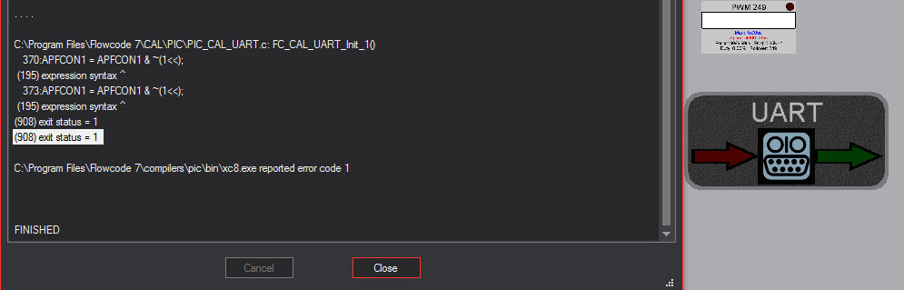

Hi Guys.
PIC16F1786 when I place a UART Component and Compile the compiler compain about the syntax of some bits in the CAL File .
Please can you have a look at this :D

Please try replacing the FCD file with attached.
Thanks!
Leigh

Hi leigh,
Thank you it compiles now fine,I will run the code on the weekend and see how it performs now I am still creating the code :D
