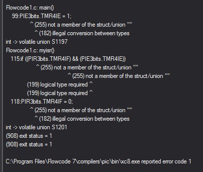

When incorporating timer 4 into a program compiling fails with the errors listed below.

Hi Zane,
Thanks for letting us know of the problem.
I have now fixed the Timer 4 and config problems mentioned. Simply extract the attached file into your "Flowcode 7/FCD/PIC" folder and restart Flowcode to load the changes.

Hi Benj,
Thanks for the fix for this. I have tried this using hardware and it works a treat. :D
