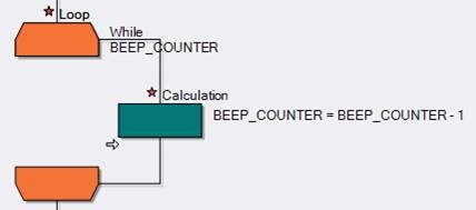

I think I have come across something similar and the code behind the loop is creating the count value as a byte and so is never going to count up to the correct value. With a fixed constant it’s easy for Flowcode to know the variable needs to be say a 16-bit value. I’ll see if it’s something we can improve for the next release.
One workaround is to change the loop type back to “Loop While” put your count variable in as the Expression and inside the loop decrement the count variable using a calculation icon.
