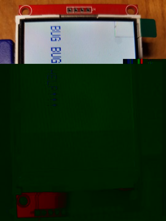

When initializing, the display behaves strangely ......
I give a photo and project
Display.fcfx
Here is the project ...
(9.44 KiB) Downloaded 189 times
Just stopped :(
Just stopped :(

You possibly need to swap your gLCD Width and Height property values

LeighM wrote:Hi,
The error remains !!!
Display.fcfx
(9.65 KiB) Downloaded 174 times

No, not the orientation, but the width and height pixel values ....

Aaaaaa !!!
Thank you!!!!!
I am very grateful to you!
Everything is working!!!!!
