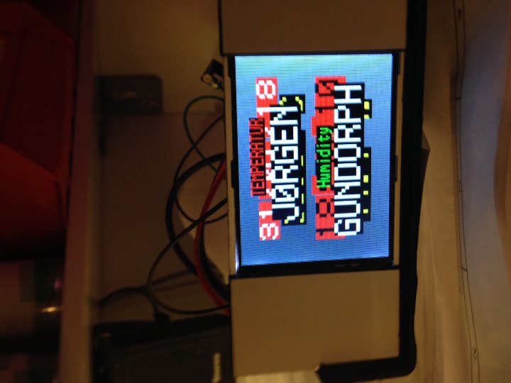

Re: Bug GLCD ILI9341
Hi again Ben!
Sorry. Now it look like it not can delete the screen.Old text will not be deleted, it writes on old text . And ithe display is slowly.
Br. Jorgen
Br. Jorgen

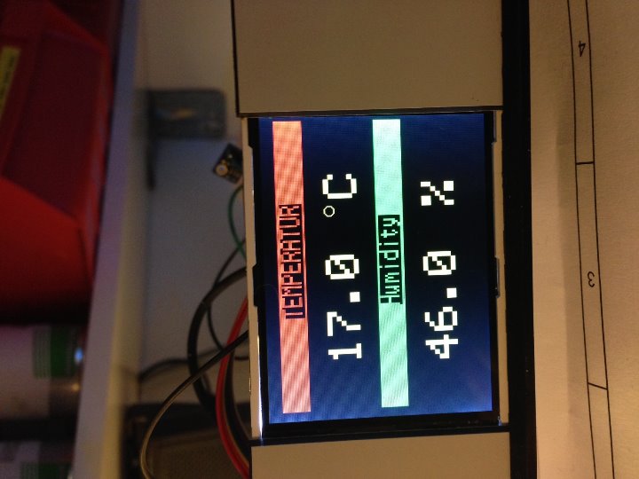

Hi Leigh and Ben!
I have probably not explained correctly
First, I have made little project with ILI9341 with a SHT21 and a GPS module. With the "old "ILI9341 component it work. I read temperature and humidity from the SHT21 and I read the time an date from GPS shown in the ILI9341 display. Created in FC7 and work perfect, glad, all component seem to be ok
So I think the settings for font and transparant is ok.
But, suddently;
Then I saw Berubeq discovered a bug concerning the CS pin. > Ben, you tryed to fix this, (and of course I also want the perfect coponent file in my FC7
) and I tested the new component with my project, and downloaded in my Arduino.
But after that it was not possible to write text in the display.
Then you made a new correction again and wrote:
"Hopefully this one now solves the problem, I had missed the CS pins toggle from a couple of macros relating to printing text".
After this new correction again:
The text write on top of each other, and it look like old tekst/data not is deleted anymore. It is loooong time to start up. And I still use the same program without any changes.
But when I use the old component again, it work again.
Hope it make sense. Nice evening to your both.. Br Jorgen
Thanks Jorgen much clearer now
Ok I have hopefully got rid of the new kinks in the component and also hopefully also added a bit of an additional speed increase.
As always let us know how you get on.
Hi ben!
Perfect, now it seems to work. I also sense it has become a bit faster. Thanks again Ben
By the way, a nice little display, and hopefully now a perfect Ili9341 component
Br Jorgen
Br Jorgen
