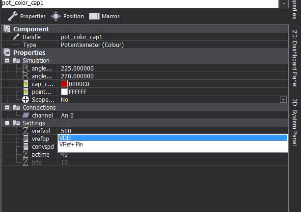

A second question, whilst researching using the VRef function I notice that with some chips, a lump of C code seems to be necessary to configure registers.
This is not necessary in Flow code
if you place an input such as a Potensiometer on the 3 or 2 D panel and select it then go to properties panel
You will see that you can select the Voltage of the Reference and also the reference to use as well as the Number of acquisitions and ADC conversion speed setting
