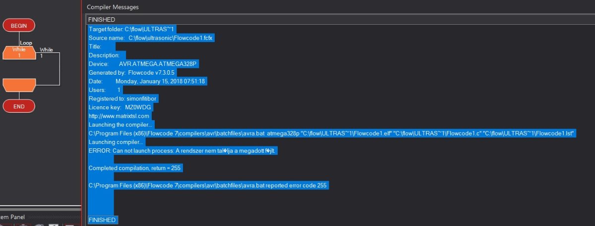

Re: FC7.3 compiele to hex error's
I get this error message for all types of controllers:
Do not compiling hex to any controller.
Flowcode7.3.0.5
Target folder: C:\flow\ULTRAS~1
Source name: C:\flow\ultrasonic\Flowcode1.fcfx
Title:
Description:
Device: AVR.ATMEGA.ATMEGA328P
Generated by: Flowcode v7.3.0.5
Date: Monday, January 15, 2018 07:51:18
Users: 1
Registered to: *******
Licence key: *******
http://www.flowcode.co.uk
Launching the compiler...
C:\Program Files (x86)\Flowcode 7\compilers\avr\batchfiles\avra.bat atmega328p "C:\flow\ULTRAS~1\Flowcode1.elf" "C:\flow\ULTRAS~1\Flowcode1.c" "C:\flow\ULTRAS~1\Flowcode1.lst"
Launching compiler...
ERROR: Can not launch process: A rendszer nem tal�lja a megadott f�jlt.
Completed compilation, return = 255
C:\Program Files (x86)\Flowcode 7\compilers\avr\batchfiles\avra.bat reported error code 255
FINISHED
Win10 64bit
Flowcode7.3.0.5
Title:
Description:
Users: 1
FINISHED
Win10 64bit
- warning.jpg (58.98 KiB) Viewed 13174 times
Have you recently updated your Windows 10 installation or your Virus scanner? (Perhaps for the Meltdown/Spectre issues?)
Windows is up to date. The antivirus is Eset Nod32.kersing wrote:Have you recently updated your Windows 10 installation or your Virus scanner? (Perhaps for the Meltdown/Spectre issues?)
I turned off the antivirus, it has no effect on the operation.
I think I'm going to reinstall Flow7.2.
STibor - This FAQ may be of help to you. Is the compile problem just for AVR?
http://www.flowcode.co.uk/faq/index.php? ... artlang=en
Stefan - I'm not getting the same compile errors as you so not sure what's going wrong there. I'll have a bit more of an investigation.
All controllers were defective.
Unfortunately, this method did not work well.He was able to fix it quite complicated.
1. Usual installation (before Flowcode uninstall and delete folder).
2. Deleted Installed Program (Delete, No Uninstall)
3.3. From the old (full) backup I copied the old backup to the Flowcode installation folder. (then v7.2 was already working)
4. Uninstall and delete a folder.
5. Install v7.3.0.5It's working now.
The UART data injector still does not recognize the COM port.
Glad you are able to compile again correctly now.

Source name: F:\PROECTOS\RED-REGULADOR FASE\STM32F407VET6\REGULADOR-82_03.fcfx
Device: ARM.F4.32F407VE
Generated by: Flowcode v7.2.1.4
Date: Monday, January 29, 2018 18:59:39
Users: 1
Registered to: volodymyr0604
Licence key: 4C3QV6
Iniciando el compilador…
C:\Program Files (x86)\Flowcode 7\compilers\STARM\batch\stm32comp.bat "REGULADOR-82_03" "F:\PROECTOS\RED-REGULADOR FASE\STM32F~4\" "32F407xx" "F4" "stm32f_ccm64.ld" "8000000" "512K" "128K"
ERROR: Can not launch process: ?? ??????? ????? ????????? ????.
C:\Program Files (x86)\Flowcode 7\compilers\STARM\batch\stm32comp.bat notificado código de error -1
FINALIZADO
C:\Program Files (x86)\Flowcode 7\compilers\STARM\batch\stm32comp.bat "REGULADOR_83" "F:\PROECTOS\RED-REGULADOR FASE\STM32F~4\" "32F407xx" "F4" "stm32f_ccm64.ld" "8000000" "512K" "128K"
FINALIZADO
Flowkode 7.3.The same error when compiled, account control disabled
С++ 2015 installed. Tell me what could be the problem.
FINALIZADO
