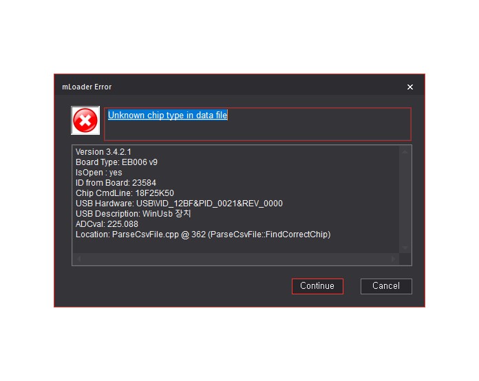

I use eb006.
Now USB error.
What can i do

PICKIT3 is no ploblum.

In my opinion this shows that the PIC18F25K50 is not supported in Mloader,
Most of us use the Pickit3 to program,you can configure Flowcode to use the Pickit as programmer ,note you have to install Mplabx as the programming SW IPE is part of MPLABx
take a look at this document and you will see how this is done
http://www.flowcode.co.uk/wikiv7/index.p ... _.28NEW.29
