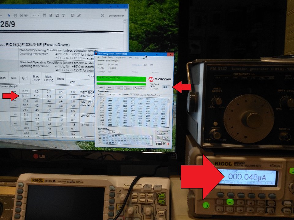

Hi Billoo, Hi all
I just finished some hobby-tests on a 18F4455 (lots of pins) on high-current-consumption when the PIC is went to sleep. Mine consumed over 40µA after the sleep-command. Not really good according to the specs that µchip is giving us.
First of all consider all things you already did : taking care of floating inputs.
* The long-term impact of floating inputs for all ports is about 2µA (depending on the environment).
* However, the desktop Fluke45 learned me a lot about the time-lapse to get the current down to 2µA. It took 10+ seconds for the current to fall-back to 2µAmps. During this lapse the battery is drained. So for energy consumption's sake, it is a huge harvesting if you can get the current to drop as fast as possible.
Second thing : do not underestimate the consumption of hardware components.
* It is quite useful to consider disabling all things you don't need, but that are enabled by default. And that is not only for the A/D module that flowcode enables by default. Take a look on the generated C-program & check the data-sheets.
* I found out, for example, that the Brown-out detector is standard enabled, but consumes a HUGE amount of current: 39µA !!! Disabling it in the configuration panel makes the consumption in sleep-mode dropping from 39µA to quasi 0.000mA. Unfortunately I did not have the financial possibility to buy a more convenient desktop-meter. So there was ending my quest for better battery-life... unless KeySight wants a place of honour in my book giving me their entry-level DMM
... not? Oh well I tried.
Hope it helped...

Re: Power Consumption on PIC12F675
Datasheets are always wright
OK i'm just proud to show-off my brand new Rigol DMM
I know EEV would be a good deal... but hell, we don't live to work, but work to live!
I also know this thing will teach me a lot of things
