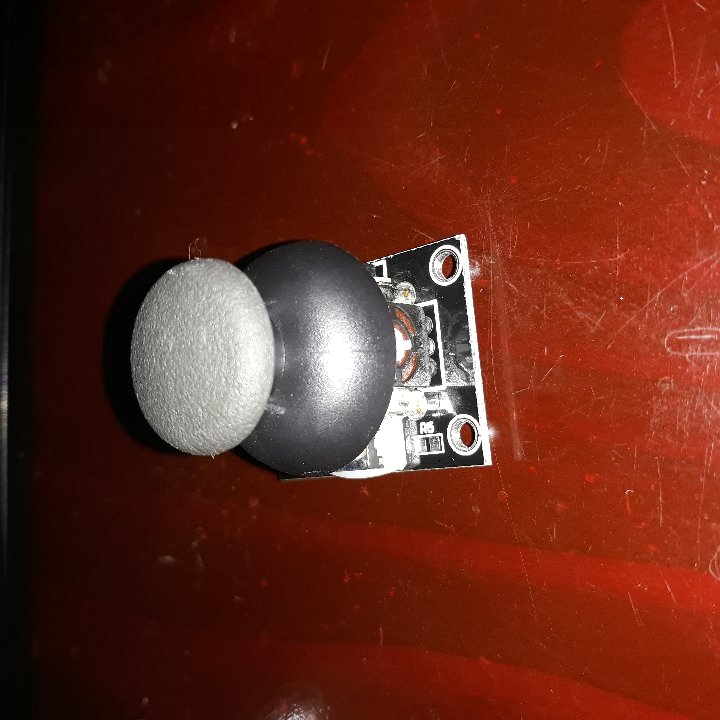

Hello I need to make a flowchart that use a mini joystick and a servomotor, please in arduino !!
(108.62 KiB) Downloaded 2020 times

This joystick use two potentiometers I believe I only need to use one of them potentiometers.

Use one ADC component in your flowchart.

Unless I'm missing something this sounds pretty straight forward.
Here is a very simple program that will do the job.
PotAndServo.fcfx
(7.21 KiB) Downloaded 419 times
What exactly are you struggling with?
