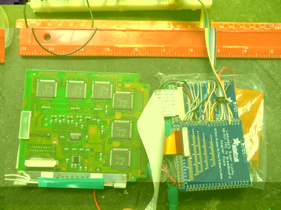

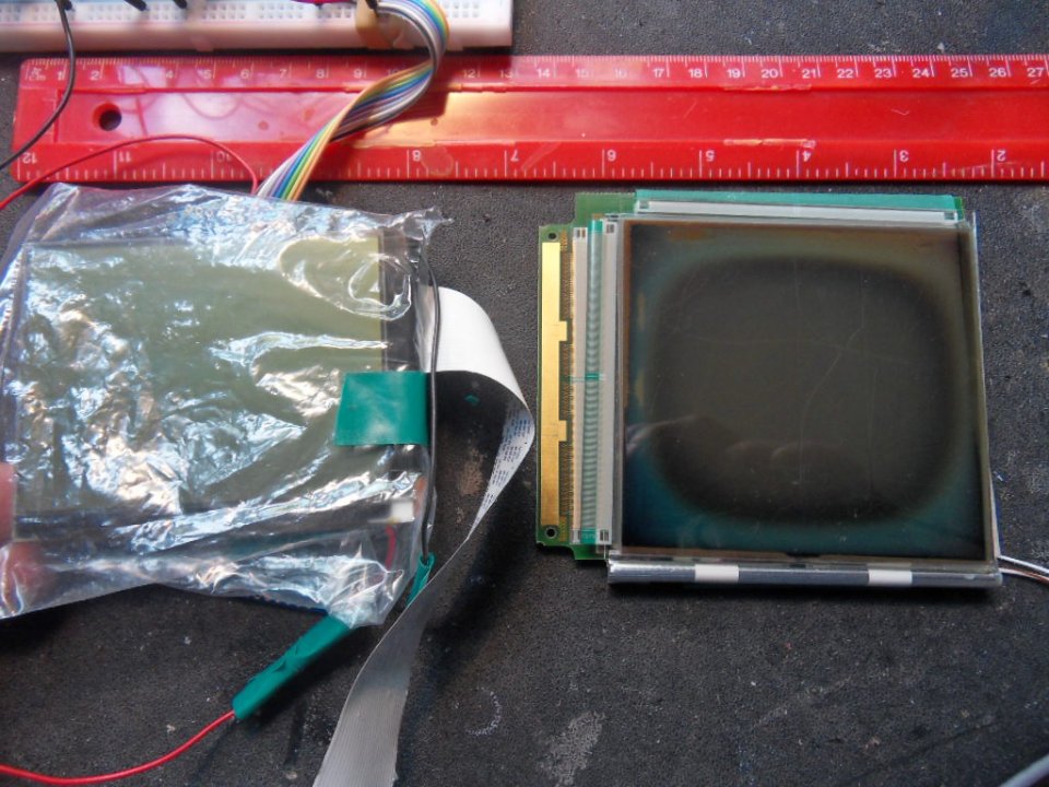

I have an expensive oscilloscope with a fading and obsolete 240x 240 pixel LCD graphical display. As 320 x 240 displays are cheaply available for Arduino and Pi use I am thinking I can get one of those and use a PIC as a protocol converter to read the existing display data and translate it to something the new display can use with just 240 x 240 of the screen.
If a PIC is synched to the row sequence and clock and reads all the 4 bit parallel column data into a 60 x 240 array it will have the complete map of the pixels. Or parse the 4 bits and save it all in a 240 x 240 array with each entry either say 1 for pixel on and 0 for pixel off. Somehow can that then be output on I2C or SPI to the new display? Or a parallel i/f is possible if it is necessary for speed. I can’t see a Flowcode macro that dumps an array onto the screen as most are for drawing lines, images etc. The help files says “Bit banging this display is possible but may be slow”. Is this what I am effectively trying to do?
I guess it may be necessary to have 2 copies of the array, one being saved into and the other being sent to o/p.
Anyone attempted something like this before?

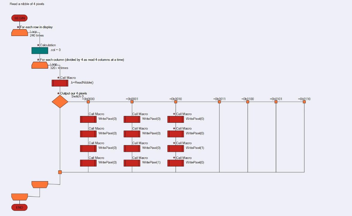

Many thanks kersing. There are lots of chips that do video conversion, e.g. from RGB to HDMI for TVs, PCs etc. but can’t find one that does what I need as the scope LCD uses a rather unique graphics controller made from 6 chips that can no longer be bought (rather than the one normally used) and the clock format seems slight unusual, although broadly follows a standard 8080 parallel monochrome i/f type. So can’t find an off the shelf display that will directly read the scope’s o/p.
So I’d need a PIC to translate the protocols.However am now thinking that maybe not necessary to store the whole frame. Instead:
• Read the 4 bit stream from scope, which define whether the pixel is on or off for 4 columns.
• Parse to single bits. How do you do that in Flowcode?
• Output to LCD one at a time to turn all 3 colours per pixel fully on or off.
• Simultaneously pass on the vertical and horizontal synch pulses and data clock
• If some retiming of those clocks is needed or missing pulses filled in the PIC can do that, e.g. using small delays.
At most need to store 2 rows in 2 arrays if want to stretch the data from 240 to 360 pixels. E.g. send 2 rows of data then a blank row. Or for columns output 2 bits then a filing 0 bit then another 2 to stretch it 50%. Or interpolate it such that if the 2 bits either side of the filler bit are 1 then output a filling 1 instead. No idea how real interpolation works but always amazed how smooth digital zoom is on say a LCD projector, with no visible gaps or image distortion.

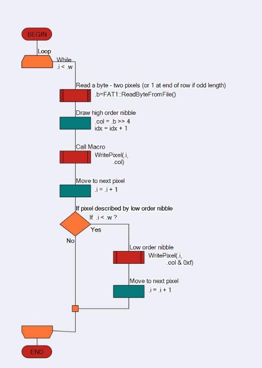

I wrote a program that decodes bitmap files for display - so while not exactly analogous to what you are doing may give some help:
The code that reads a single row of a 4 bit file is : (may appear at the end - I haven't got the hang of getting images to appear mid message?) This assumes that each 4 bits are describing one of 16 colours for a pixel (WritePixel uses a lookup table (an array) created using the files colortable) - if each bit is one pixel (on or off) then mask and compare to 0
In pseudocode:
If helpful - I can post the code that handles 1 bit 8 or 24 bit files....
Combining nibbles to form bytes (or indeed bytes to form words) is easy in flow code
In a calculation macro
Which shifts a left 4 bits and then adds b. Parentheses probably aren't strictly necessary but will prevent unexpected operator precedence 'surprises'
So use them where they clarify!
Thanks to etsdriver for the tip. Just spotted a bug too.. second pixel should be. b& 0x0f rather than .col

For speed you could possibly either use a switch (or a jump table, though not easy in Flowcode)
So in pseudo code:
A lot more code but mostly a cut and paste job.
Another approach might be to read the entire frame to memory - then process it ( and write to output) in the delay between frames (assuming a 50hz refresh)
This would make it much less time critical.
So in pseudo code:
b = Read 4bits
Switch on b
0:
Writepixel(0)x4
1:
Write Pixel(0)X3
Write pixel(1)
2:
Write pixel(0)X2
Writepixel (1)
Writepixel(0)
15:
Writepixel (1)x4

Sorry - the pseudo code is just meant to describe the steps required to do what you want to do....
It is easy to do a similar job in Flowcode - create dummy macros for sub routine - build the top level and then work down to the lower level routines. (This is known as "top down programming")
So what I was trying to describe above - in Flowcode:
Note that Flowcode limits switch statements to 10 cases - so unfortunately you'd need a decision to divide into two first first...
I would try using a bitwise mask first - (as mentioned above:
The code is simpler and I think that the speed will be almost as quick as the switch statement (which adds an (unknown) overhead - and although you would hope otherwise - may be slower for some values?)
You could 'unroll' the loop for a little extra speed
As an aside:
Using constants for the bitmask would be equally valid - I tend to use a variable partly because I like 'loops' to do the repetitive stuff but also because I (naively) believe that it will be held in a register and access 'may' be quicker than accessing a constant from a memory (or maybe I am too accustomed to optimizing compilers
and actually the code retrieves the value, uses it in the & calculation, retrieves it again for the shift then stores it back to memory) Maybe Ben / Leigh could comment on this
Flowcode converts everything into C pretty effectively at one line per macro call (though this does not necessarily relate to only one instruction per macro call!)
I would suggest getting the basics working first ie get the output display working - then get input working to a buffer and get some output reflected onto the display (even if it is just one frame / alternate frames etc).. Colour, display stretching etc can come later if needed!
.mask = 0b1000
decision
(.b & mask) == 0
.mask = .mask >> 1
As an aside:
.b & 0b1000 ...
.b & 0b0100 ...
.b & 0b0010 ...
.b & 0b0001 ...

Front and back views of old and new displays together here. You can see the large central "burn" on the old one which causes it to be almost unreadable. The plastic bag on the new one is meant to prevent shorts between the display's PCB and my interface PCB but did not save the clock line.
