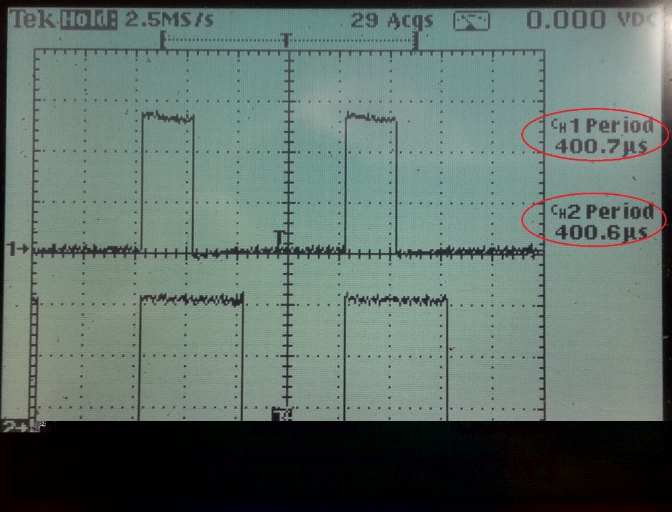

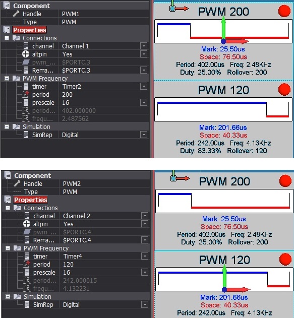

I have downloaded the latest updates. I can get both PWM channels to work. However it looks like when using T4 or T6 to drive a given channel it looks like T4 and T6 are getting their values from T2. When using T2 all the timing values seem correct.
Zane
Zane

I was wondering if you have had a chance to follow this up. I have also found that when using T2, T4 or T6 to drive an interrupt they all work at the given intervals set and when T4 and T6 are used with a PWM channel they experience the problems mentioned in the last post.
Zane
Zane

Right I've managed to spend a bit more time on this now and can't seem to find any problems in the code, though there could be problems lurking.
Can you explain a bit further what problem you've noticed and ways to try and replicate the problem.

Thanks for looking at this for me. I have attached a small program where the two PWM channels are used. Channel 1 has timer 2 assigned to it. The values used for the period and the duty cycle work as expected.
Channel 2 has timer 4 assigned to it. Any changes to the period are not reflected in the output waveform. However when the period for channel 1 - timer 2 are adjusted they affect the period of channel 2. The duty cycle of channel 2 works ok. I have tried using timer 6 in place of timer 4 and it also seems to have its period referenced to timer 2.
Timer 6 in the program is used to drive an interrupt routine and it is set to activate every 1ms. From within the interrupt routine an output is set to toggle on and off every second, this works correctly. So it looks like the timing issue so far seems isolated to the PWM function of the chip.
Another output is toggled in the main routine every 1mS, driven by FC delays. The timing of this is also correct.
Also as a side note i have noticed when selecting what channel is to be used for the PWM, the drop down menu has four available channels. This chip has only two.
I hope this is of some help.
Zane
Theoretical outputs for channel 1 and channel2.
Actual outputs from PIC.
Scope Channel 1 = PWM channel 1
Scope Channel 2 = PWM channel 2
Zane
