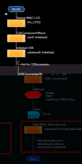

Not understanding the background workings of the USB slave component I ran in to the following problem with my MIAC and CAN.
Frist is is necessary to say that I can not trigger the CAN send function from the USB Slave firmware(I did and it functions) as from a Windows GUI

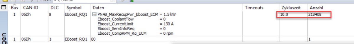

the Timing move around and the CAN TX cycle time is not stable enough therefore the Machine sometimes complains CAN Timeout (we see oscillations between 8 and 14mSec with windows controlling the Cycle time ,

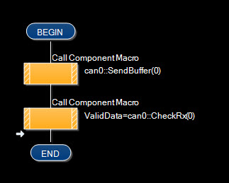

Therefore I made a Custom Interrupt with TMR1 (10mSec ) and then CAll a macro to send the CAN message this function spot on cycle time is correct and no issue !
Now the Problem when I now use the the CAN component call inside the macro/Interrupt then the CAN freezes and it seems the USB also
CAN macro called in the TMR1 Interrupt
CAN freezed no transmison and also no USB activity in the labVIEW GUI
Any Ideas why this would happen or comments to achieve my goal would be appreciated?

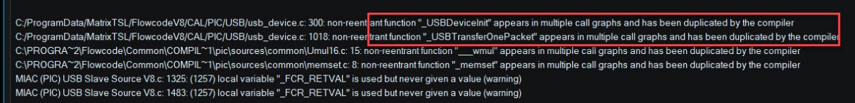

another concerns is that I only use the CAN component in the TMR1 interrupt however the compiler is complaining that there are multiple calls and it has duplicated the functions the same is for the USBslave component not sure if this is normal or some sort of issue that will byte me later

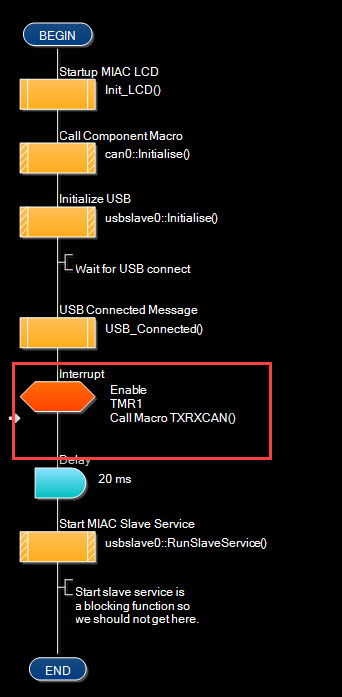

I agree with this and it is as we always do this however with this USBslave firmware from MATRIX there is no main loop to set a flag in ,if this is allowed to Run a main loop I for sure go this way.

Here are the MATRIX Source Main macro in my understanding a main loop is not used or will help as the comment says
this is a blocking function once you start the slave service it always sit in the slave service .

Just checked the UsbSlave Source (Firmware) Matrix project has this multiple call graph problem in both FC7 and FC 8
Not sure if this is an issue or not just saying

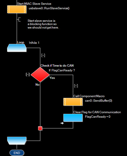

I have tried to add a while loop and do the Flag in the Interrupt and execute the CAN in the main(while) loop however as mentioned above it seems the USB slave RunSlaveService is a blocking function my code never enters the main loop (a bit expected as the comment from MATRIX in the source code shows
:D I am in big trouble believe :D :D me

Yes you're right I hadn't thought of that but yes the RunSlaveService macro is blocking so you can't do a while 1 loop.
So instead can you do this. Take any CAN related calls out of the USB Slave service macro. Instead set global variables to flag that CAN activity needs to happen.
Next using your timer interrupt monitor the variables and service them before clearing them ready for the next request.
This way the CAN SPI should only be being used in one interrupt macro and so shouldn't clash.

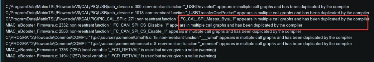

Ben I checked now and all CAN calls are removed from the USB SlaveService once I place a CAN call in the TMR Interrupt the mulitiple call graph warning comes up.

Re: Miac CAN Problem
Hi Peter,
The reentrant warning is because the CAN init is called in the main and the CAN functions are called in the interrupt. Both use the SPI routines but there can be no collision because the init finishes before the interrupt is enabled.
I tested the warnings go away by adding the init to the interrupt on first call.
In your timer macro do the check RX and store the return into a variable. If there is a message waiting then also store the ID and data bytes. Access these variables in the USB slave macro.
Similarly in the USB slave macro when you are asked to send a CAN message simply add the ID and data to different variables and check these variables as part of your timer interrupt.

Slowly we are getting off the hook now :D implemented what we discussed and the USB and CAN are working now and the CAN cycle time is spot on.
Thank you very much once again you helped me a great deal ,Appreciated :D
