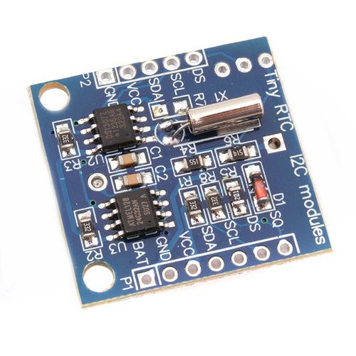

Re: DS1307 F7.3
Hello benj
Thanks for the feedback, I already use a capacitor of 0.01μF, but it did not help.
I use this template in the attachment
- ds1307 RTC.JPG (44.77 KiB) Viewed 37548 times
