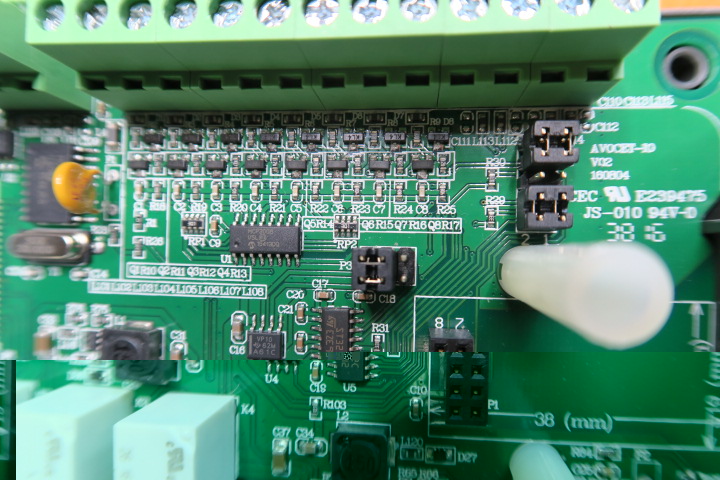

Hi kersing
Rigtigt mange tak.
Never used these terminals before. But is now connected as you refer to;-)
You need to connect to Miac RX and TX, the pins upper right, next to the power connector
Here' I do not really know what you mean here!
"And of course set the component to use that serial port"
Is it RX Remap Pin Port E.1. Or what do you mean? Should "Port E.1" be connected to a serial port. Where is this "serial port"?

The serial port settings you show are correct IF the jumper settings in the Miac are correct. Check the data sheet to see the jumper settings (page 11, one of the first three diagrams is OK)
Check the documentation of your GPS module to see if it uses 9600 bps or 38400 bps for the communication speed.

Would like to be careful here not to pills too much in dsPIC Miac!
Can you see which jumper to move And to which??

Please check the documentation. I mentioned the page and settings in my previous message.

Which jumper settings in the Miac are correct????
Is this this jump settinge to be used below?
So that one is correct, but the settings in your picture are correct as well.
