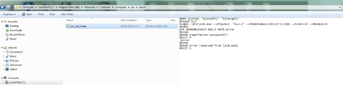

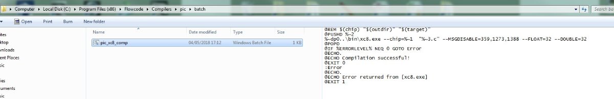

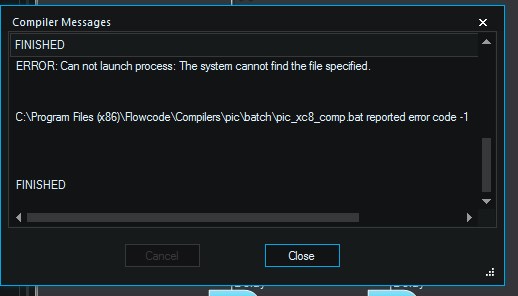

I have just installed Flowcode 8 and wrote a simple program to try out the new features and get familiar with it. However when I tried to compile to chip I got the message
"ERROR: Can not launch process: The system cannot find the file specified".
C:\Program Files (x86)\Flowcode\Common\Compilers\pic\batch\pic_xc8_comp.bat reported error code -1
I have looked in the above batch folder and have attached a screenshot of the file present for your perusal
Could you please assist
- 2018-07-17_15h04_14.jpg (39.53 KiB) Viewed 19065 times

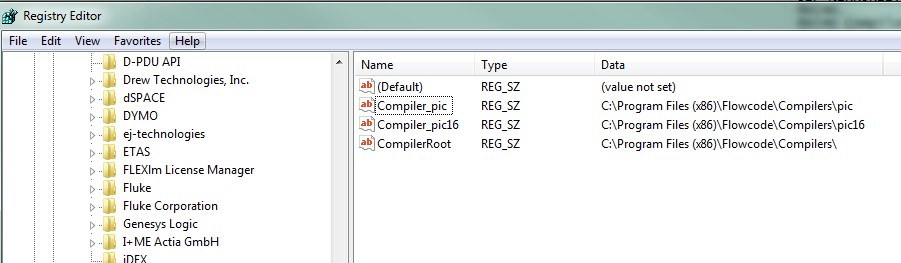

Re: Missing pic8 compiler file
Hi DanielM,
I checked the compiler location in the windows registry editor and it was different i.e. it did not contain the "common" folder, so I copied the "pic" folder into the "compilers" folder as per the entry in the registry editor. This still do not work and the error message stated that the system could not find the file specified.
Again I have attached some screen shots
kramtlas
kramtlas
- 2018-07-26_13h46_48.jpg (26.84 KiB) Viewed 18929 times
- 2018-07-26_13h47_13.jpg (32.69 KiB) Viewed 18929 times
- 2018-07-26_13h51_04.jpg (53 KiB) Viewed 18929 times

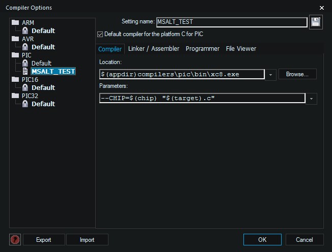

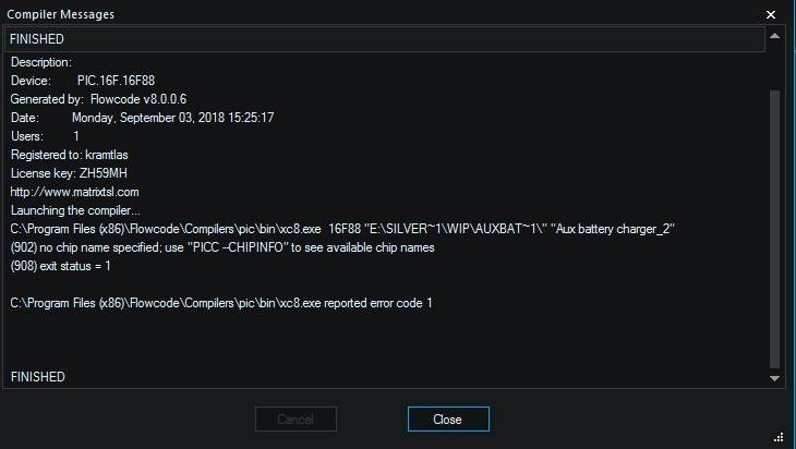

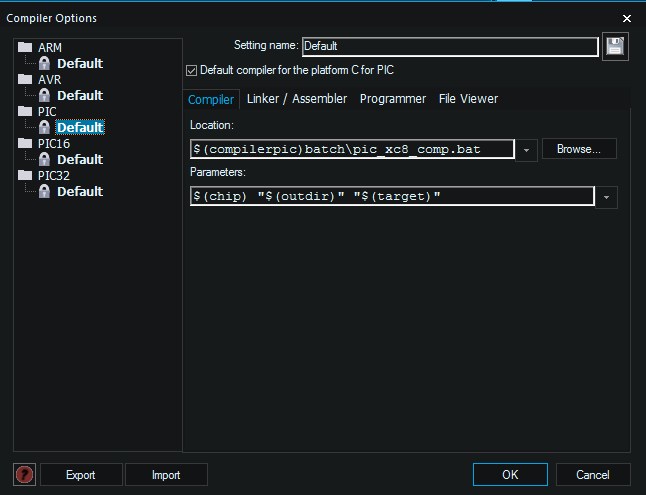

Hi Daniel,

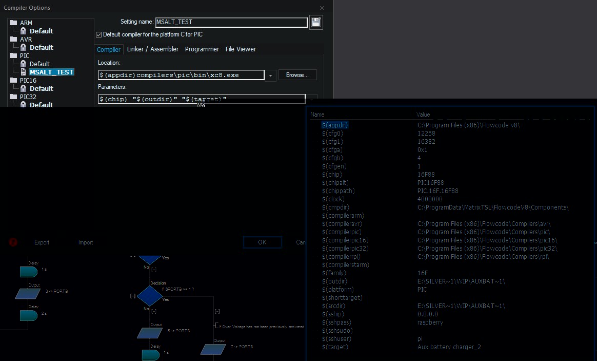

I managed to sort the problem out. The default settings for the compiler seemed to be the issue, I looked through the help menu for compiler settings which were different to what the Flowcode 8 settings were preset to. I altered them to the settings in the help file with the omission of the end part which is highlighted in red and the compiler now works. I have attached files to show the changes made and the last file shows the compiler working although there are a few issues which I have made notes on which I would be grateful for some assistance with.
I will send a second post as I can't seem to add more than three attachments.
Kramtlas
Kramtlas
- 2018-09-03_15h47_04.jpg (124.57 KiB) Viewed 18684 times
- 2018-09-03_15h25_53.jpg (44.74 KiB) Viewed 18684 times
- 2018-09-03_14h22_34.jpg (42.29 KiB) Viewed 18684 times

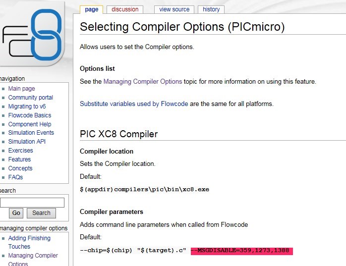

Additional files
- 2018-09-25_14h05_49.jpg (63.09 KiB) Viewed 18682 times
- 2018-09-03_16h13_49.jpg (76 KiB) Viewed 18682 times
- 2018-09-03_15h54_02.jpg (42.73 KiB) Viewed 18682 times

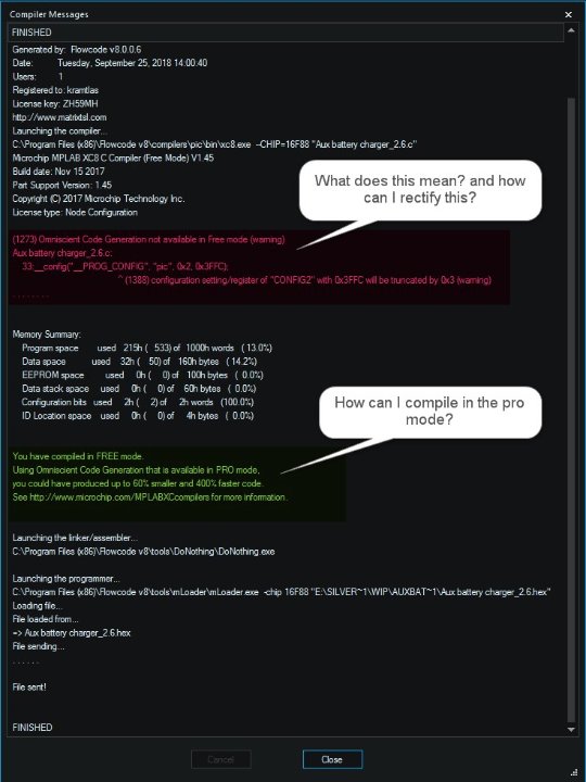

Yes thanks, I appreciate your assistance. I finally got the compiler working and have sent a post but basically it was the default settings that were preset with the Flowcode 8. There a few faults reported which I have asked for some assistance with but at least it works now.medelec35 wrote:Hi kramtlas,
Just catching up.
Did you get your issue resolved?
Question. Do you know how to set the ref (-) and ref (+) for either the ECIO 40 or 16F88 Pics? I was looking for some example codes but am struggling to find any that explain how to do it.
Kramtlas

Glad you have got the compiler working now.
Currently, the only choice within ADC component properties is for Ref to be between +Supply and GND, FVR and GND (If supported by device) or VRef pin and GND.
Any other options will require a small bit of C code change within relevant CAL_ADC.c file.
Hi kramtlas,
I'm glad that you have your compiler issue resolved.
Just to confirm, the image of your compiler settings with "$(appdir)" is now what you have it set to, and your compilers are now located in "C:\Program Files (x86)\Flowcode v8\compilers"? Did you move these yourself? Because it seems at odds with the location given in your previous posts. Did you move the location on your hard disk in order to be consistent with the settings you received from the wiki? I am trying to establish whether there is a problem with paths/registry, or if the issue was in fact just the trailing arguments to the batch file.
Regarding the messages you receive in the compiler window: This is due to Flowcode's usage of the standard version of Microchip's XC8 compiler. It is possible to purchase the PRO license for XC8 yourself, and use it with Flowcode, but as far as I know you can only purchase the license with a monthly subscription. For most people, the benefits of the PRO compiler are not worth the cost. You can find more info here https://www.microchip.com/developmentto ... 006021-sub
Daniel
Daniel
Hi Daniel,DanielM wrote:but as far as I know you can only purchase the license with a monthly subscription
You can also have the professional version (SW006021-2H) for a yearly fee of about £150+ vat if you want to keep it up-to-date as that is for updates and support only, not for a licence.
But to do that you must purchase the professional licence first for a one-off charge of £762.47 + Vat
After paying £762.47 + Vat it stays professional for life, you just won't be able to use on compiler updates that come out a year or later.
The compiler version will have to stay at the last update before the year ran out.

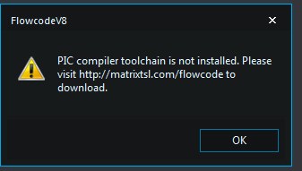

I got the same PIC missing compiler after I upgrade the Flowcode few days ago.
It looks like there is an error on Matrix batch installation file. Please, check it and release a fix.
It is amazing that after almost 1 year the first issue it still happening.
I download and used the REPAIR option of the PIC toolchain and it does not help to fix the problem.
By the way, only the ARM toolchain does not have the common folder.
I was able to fix the problem copying the C:\Program Files (x86)\Flowcode\Common\Compilers\pic to C:\Program Files (x86)\Flowcode\Compilers\pic.
