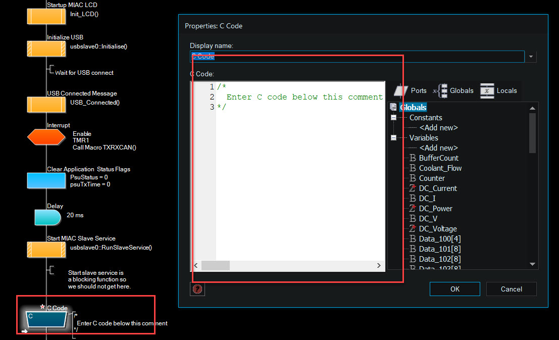

planeri wrote: - Is there any direct method to change or store the value of a configuration register (other than the ones listed in the "Project Options/Configure" tab) without adding C code? Let's say I need a TMR1 overflow interrupt with a precise lapse of 100 ms and I don't want to call the interrupt macro many times with a counter, in C I usually could initialize the TMR1H and TMR1L registers in each interrupt call with the appropiate values. In flowcode, do I need a custom interrupt for this?
Hi welcome to the forum and I am sure you will enjoy Flowcode :D
You are not limited to the base settings FC allows for interrupts or any any thing for that matter,
You can access any register in a micro as in any C language programming by using a C Call Icon on your Flowchart.as you see below you can now add your standard C programming

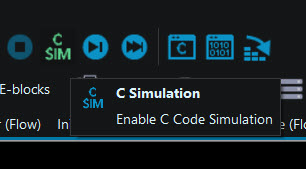

You can also include your C code in the simulation of your Flowchart by using the C Sim button

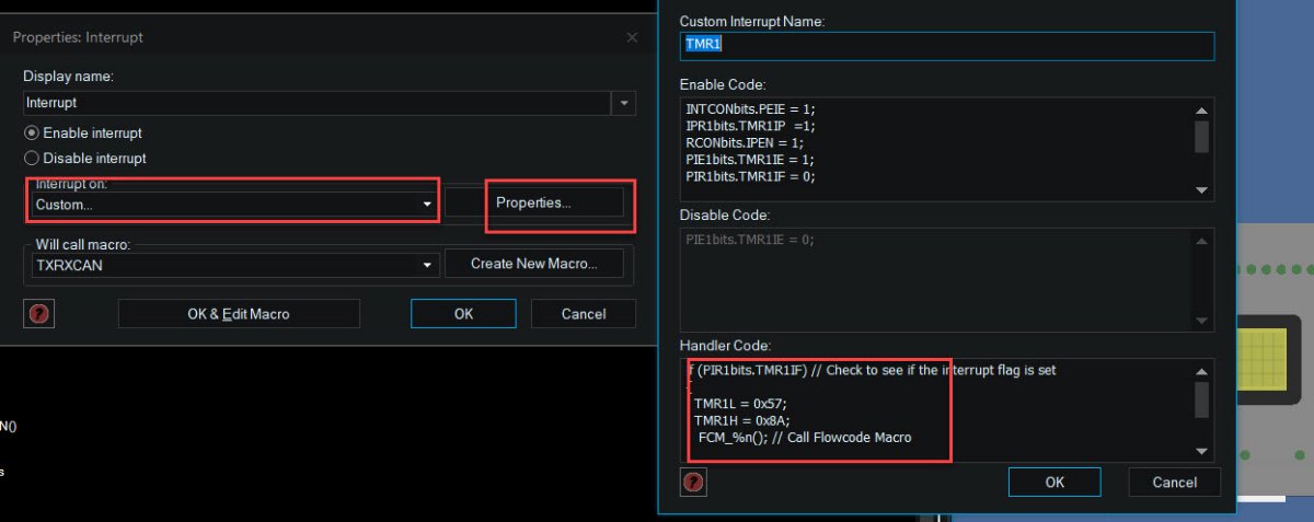

You can setup your own custom interrupt and configure your interrupt as you wish here is an example of a Timer interrupt which I configure
to interrupt at my specified time .This methodology also apply for any other interrupt by using a custom interrupt and configure the interrupt to your needs.
