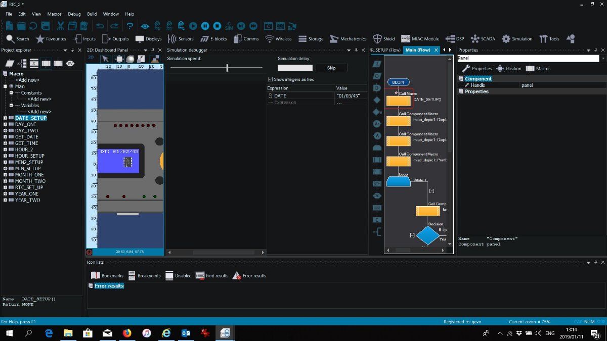

Hi Gavin,
You are getting on well :D
The simulation debugger is very useful for helping with these kind of problems.
If you set a breakpoint in your GET_DATE, run the simulation, when it stops on the breakpoint add DATE to the variable watch.
You can then edit the value of DATE to help see what is happening ...
Then Step to the next icon and see how the DATE changes ...
So this is the fix ...
Hope that helps
Leigh

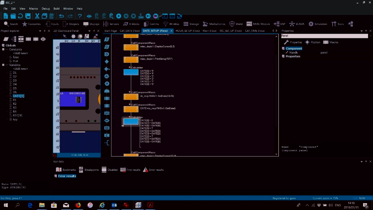

I still can't seem to see the 2?
I used the calculation in Date Set as:
DATE[5] = '5'
DATE[4] = '4'
DATE[3] = '3'
DATE[2] = '2'
DATE[1] = '1'
DATE[0] = '0'
I used the Calculation as
DATE[8] = 0
DATE[7] = DATE[5]
DATE[6] = DATE[4]
DATE[5] = '/'
DATE[4] = DATE[3]
DATE[3] = DATE[2]
DATE[2] = '/'
DATE[1] = DATE[1]
DATE[0] = DATE[0]
And attached is what I get

The RTC:SetDate string should only be 6 characters and without the '/'
