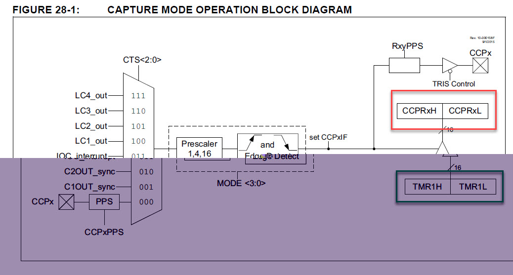

I would not use any Clock less that 32Mhz and my reason is your 100Khz signal has a time of 10uSec a PIC 16 running at 32Mhz has Tcy of 125nSec
so the time you have between catures is 10/125 = 80 cycles, not much to calculate the frequency and other stuff from the captured values.

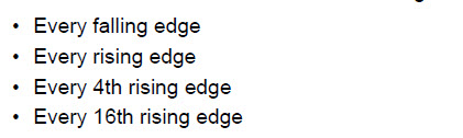

Note that if you do not need to capture each transition of the signal you can set the Capture module to capture every 4 or 16th pulse allowing you to get more time between the captures for the other things you need in code
But I am sure you can capture the signal and the chip has 2 CCP modules you can detect 2 signals at once .
Check out the datasheet section Capture and compare and you will see you can achieve what you need to do with this chip with just using the chip correctly.
