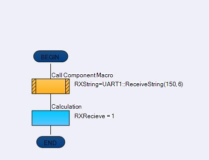

As an alternative - in your receive interrupt just use a receive string - and assign the data to a string Here RXRecieve (sic) is used as a flag to let the main part of the program know that there is data to process.
Check here: http://www.flowcode.co.uk/mmforums/viewt ... 84&#p33484
Where Ben gives some source for a circular buffer.
Might be quite a bit of work!
