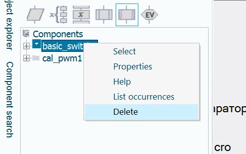

The macro is not removed!
Post by Osta »
No variables working with it.
How to remove ?

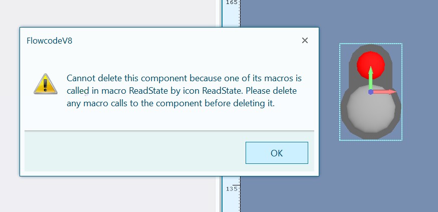

Hi Osta,
If you have a call macro which also contains a Component,
then the component can't be deleted from panel until it's deleted from within a call macro.
I'm assuming that was the case?
