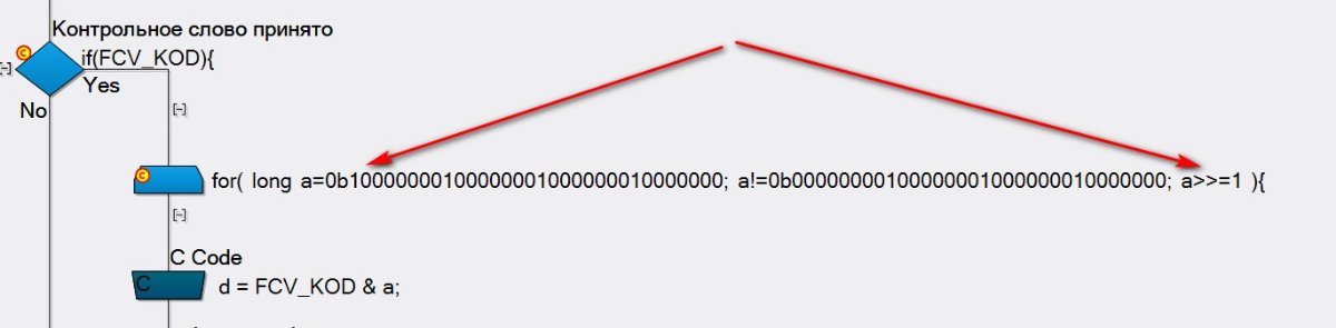

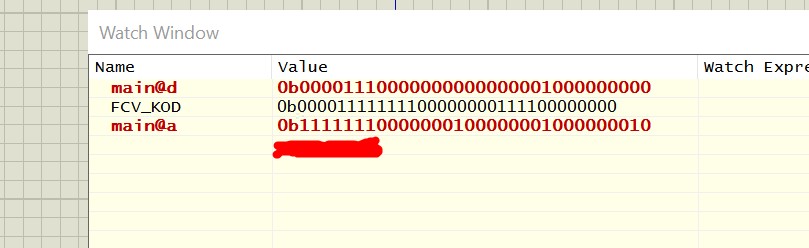

No exit from the for loop!
Shift error
for
for
err
err
ERR a.jpg (37.68 KiB) Viewed 2617 times

You likely need to use an unsigned long

Hi LeighM!
I thought the default would be an unsigned variable.
It's working !
