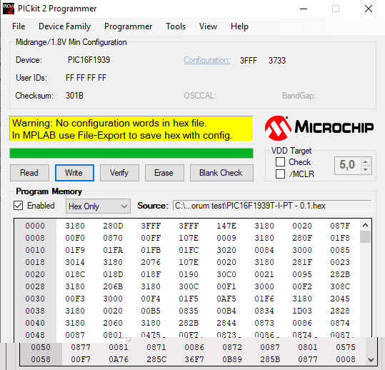

I have made a simple Flowchart to test If the ICSP is working. The Flowchart is working fine but when I upload the .hex file with PicKit2 I get this error: (see below)
I also don’t know if the configuration bits I have set are the good settings for this chip. I’m making use of the Internal Oscillator. Could someone please check this bits?

Suddenly the above error from PicKit2 goes away
