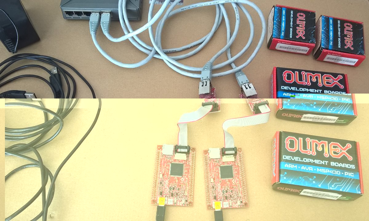

I just started to do the same. Here is my hardware I like to use. I use FC8.
I have a little experience with the PIC32MZ2048EFG
Which pic or hardware do you use?
https://www.olimex.com/Products/PIC/Dev ... e-hardware
https://www.olimex.com/Products/Modules ... -ENC28J60/

Just a little note. You can not connect the PIC directly to the computer with a network cable. You need a HUB or a cross cable.
I ran the Olimex board and included the demo program FC_ENC28J60_Example.fcfx.
It's not working. I have to look...

I found the problem. Just insert the portnumber (80) to the commands.
ping is working from my computer.

I did a small change in the pointer and now I can acces the Pic with the Internet Explorer under Ip 192.168.1.90
and change to page2 ....
and with the TigerJython (Python) I have acces too.
TigerJython is free and you just copy the text in the program.
Now I found in FC8 the component: NetworkComms1
I think I gon on with this component.
