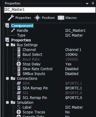

1) When starting Flowcode with this microchip, there is a possibility to choose the I2C ports. I needed the C0 as SCLK and C1 as SDAT.
channel 1.jpg (68.94 KiB) Viewed 3914 times
But the Flowcode program did not work.
2) But it is curious why one could change the ports in case of channel 1, because ports should be C3 and C4.
So, I changed the ports to C3 and C4. The breadboard setup with is setting did not work either.

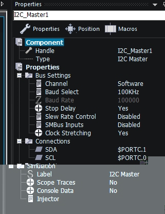

3) Now I changed the Flowcode Bus settings channel to “software”. Curious that the connections were fixed to C3 and C4 and could not be changed, as expected. But this works.
Question: Is it correct that one can change the I2C ports in case of "channel 1"or "channel 2" and can not change the ports in case of "software"? It seems not logic to me.

With the two hardware channels you should get the extra Remap properties that allow you to set the hardware channel pins. With the software channel the remap properties should dissappear and you should be able to set the pins by directly editing the SDA and SCL properties.
All working nicely for me here though I am running 8.2 (due to be released later today).
