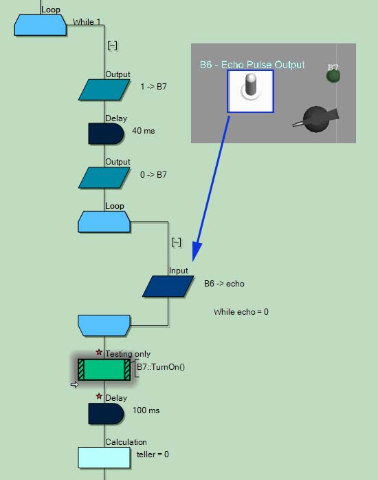

I'm having some troubles with programming a distance sensor and a servo.
The servo needs to turn 90 degrees when there's an object within 10 cm in front of the sensor.
Can anyone help me?

Hello
To pass the 1st loop (in the Main loop) you need to create a simulating the HC-SR04 B6 input - in your situation it will be switch component.

Hi B electron,
The forum rules here state:
5. The “Tips and Tricks” sub forum is for sharing your knowledge and NOT for starting off with asking questions.
I will move the topic to V8 section as that is what I'm assuming you are using?
It looks like you are basing your flowchart on mine, but the delays are the wrong values.
Here are the flowcharts side by side:
