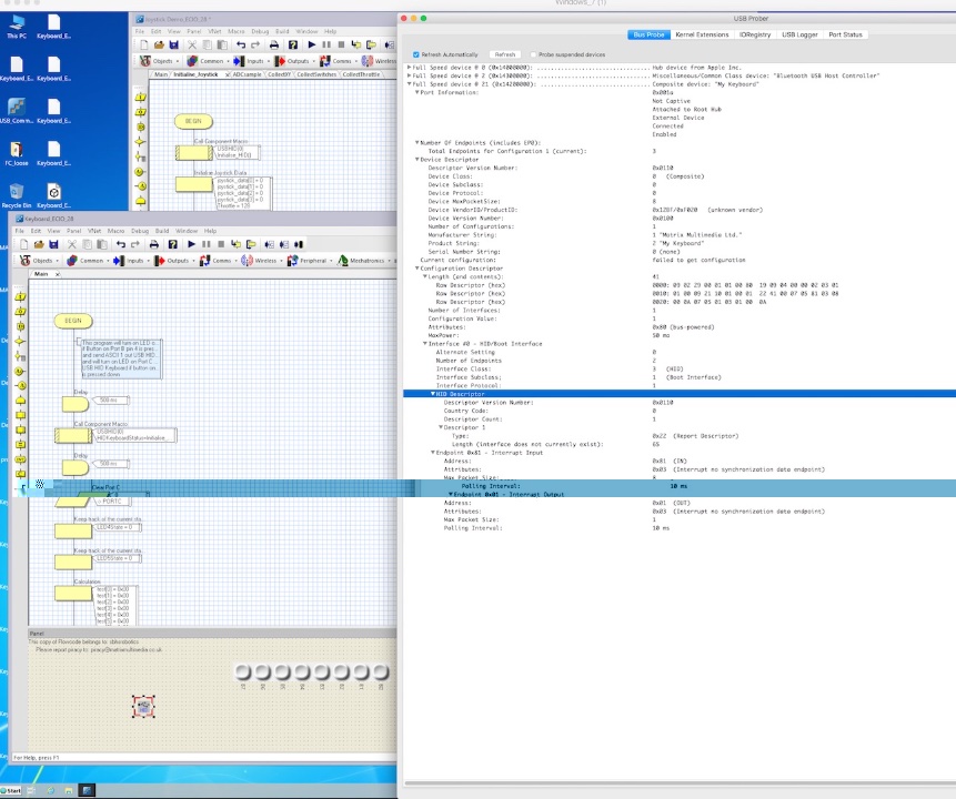

Re: USB PC Keyboard
Does anyone have any idea why the keyboard isn't recognised here please?
It does not recognise the HID as a keyboard for some reason and it's driving me bonkers!
Thanks in advance...
